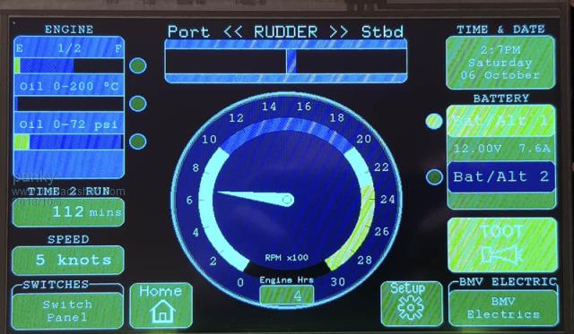

The fact that the display is completely stable with complex text and GUI elements displayed would indicate that in genereral, it is 99% compatible - the only issue is colour and in fact it is red that is missing although I do get some white (ish) elements displayed. I have tried varying combos of colour using the CLS command but most turn out to blue through green. Could be timing related to passing colour info?
Screenshot is as shown below
Ignore the striations - they are an artifact introduced by the camera. All colours, while wrong in colour are solid blocks and bright and clear. The needle in the circular gauge should be gray but comes up as off white with a blue tinge. The blue in the centre of the gauge should be darkish gray as should the background on the engine frame and so on and so forth.

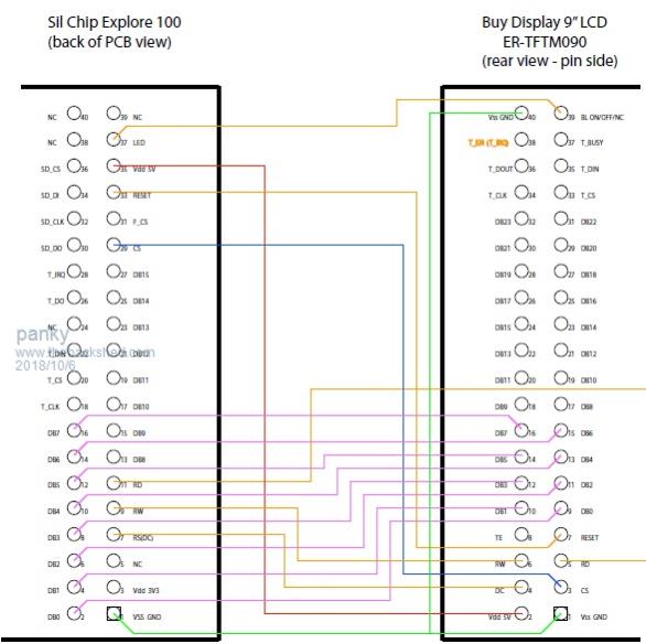

Diagram of the pinout as below

Good experience all around. I am now working on an adaptor board that will connect to the 7" header and re-map to a header for the 9". Have not had a chance to test on MMX or ARMMite platforms yet but hope to get to that over the next few weeks.
