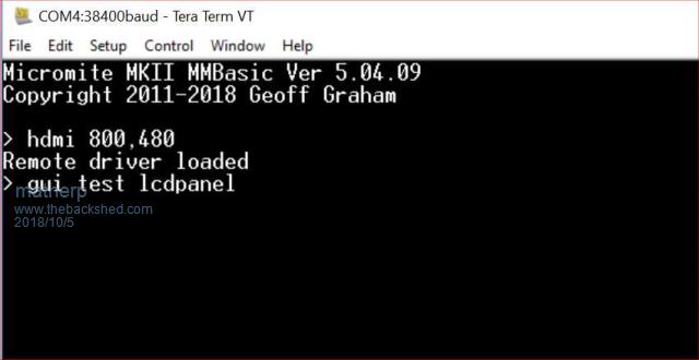

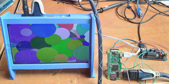

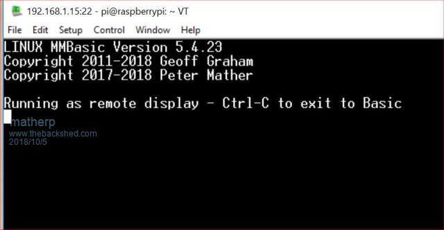

Using MMBasic running on Pi-Zero as an HDMI I/F for a MM2.
A loadable CFunction display driver on the MM2 (running completely standard MMBasic) communicates over a 4-bit parallel I/F to the Pi-Zero. This is also running MMBasic with a new feature OPTION REMOTE ENABLE which tells it to listen on the 4-bit port for graphics commands.
Surprising, the Pi is very poor at acting as a slave device and receiving high volume data but using the 4-bit i/f I'm getting a reasonable throughput.
Reliability isn't there yet as the Pi seems to crash out of MMBasic after 5 minutes or so but this could just be a wiring issue.

Posts: 12084
Posted: 06:01pm 06 Oct 2018
  Quote  Am I correct in assuming that the 'source MM' can only output graphics to the 'slave Pi-MM' i.e. it can not also drive another TFT such as an ILI9341?
Yes, of course. The code on the MM2 is a normal loadable display driver and you can only have one driver at a time
Video here
Note circles are worst case for the I/F as each pixel on edge of the circle takes an 18 byte message, exactly the same as a clear screen command.
So
timer=0:circle 200,200,100,,,rgb(red),rgb(blue):?timer
gives 155mSec but
timer=0:box 100,100,200,200,,rgb(red),rgb(blue):?timer
is 11msec
Remember, of course, this is a 800x480 display being driven by a 28-pin MM2 at 40MHz
