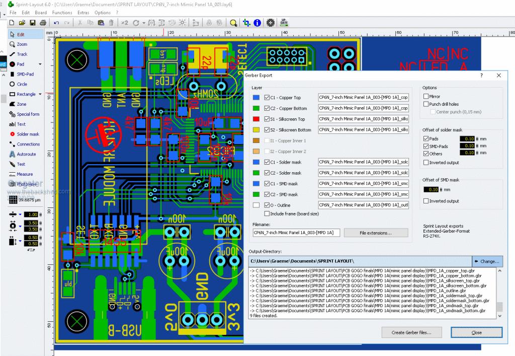

Hello everyone, I think several people in this forum use the company pcbgogo for the manufacture of printed circuits and apparently their costs are very cheap and their service very fast, I need to design some pcbs and I will use sprintlayout 6.0 some information that can give me about? as for example what kind of files do I have to send? someone who can provide me with an example of a design with sprintlayout that they have sent to this company to see what I have to send, thank you in advance for your help.

I use GOGO and Sprint Layout 6 for all my PCB work.

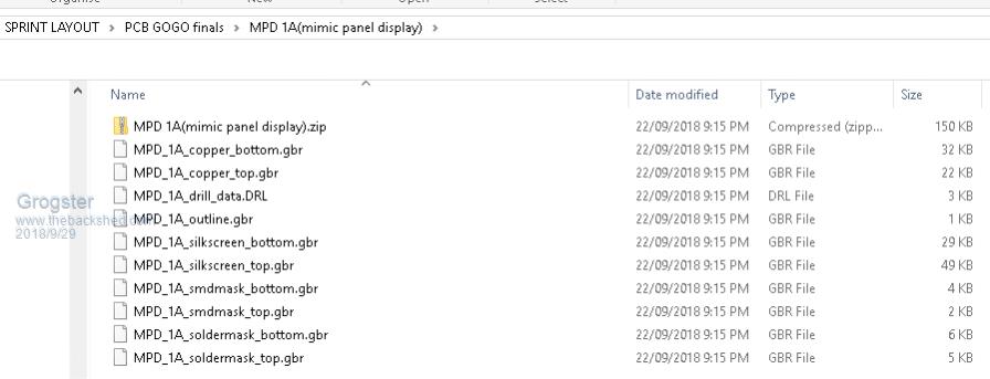

Like any other PCB design software, you need to send GOGO a full set of Gerber files - one file for each layer of the board. For a double-sided board, this usually results in eight files: Top Copper, Top Silkscreen, Top Soldermask, Bottom Copper, Bottom Silkscreen, Bottom Soldermask, Board Outline and the last file is the drill data for all the holes.
In Sprint Layout 6, you do this via FILE/EXPORT/GERBER EXPORT.
I select 0.1mm for the soldermask and SMD offset. In my case, I export two additional files, which are the SMD masks for the top and bottom SMD parts just in case the factory need them.

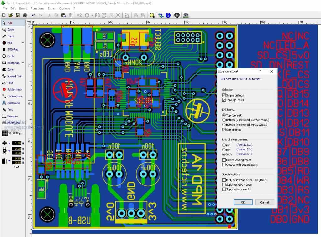

To export the drill data, go to FILE/EXPORT/DRILL DATA, and click OK. Most PCB houses use 2,4 Inch format.
That done, look in the folder you saved your files, and use something like 7zip(google for it if you need it) to zip all the files into a single ZIP file. This single file containing all the gerber files is what you upload to GOGO or other PCB house.
