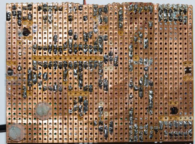

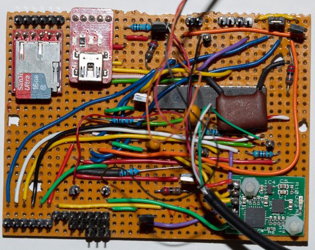

WhiteWizzard - Yes, well when I designed this layout it was fairly clean and logical, but I have had to make so many addons and mods over the past year that it is now a right mess! That might be the cause in fact.
These photos are missing the 10K resistor to pin 1 as I just decided to replace it and resolder. Board is covered in a conformal coating (it goes in a model boat in an IP68 box), which I have to scrape off every time I change anything.
Decoupler is tantalum. The Vreg is built into the USB-to-serial converter seen to the right of the microSD card. I power this from USB when testing but from lithium power pack when sailing. This 3v3 only feeds the MM. Lots of stuff on MM: serial line from GPS unit, I2C from compass/gyros, SPI from shaft encoder, A-to-D from power voltage, other pins sensing digital data or pulse length (from anemometer), the SD logger hanging on console output, as is a LoRa transmitter (via a fet switch).
Probably not much you can say other than "It's a mess, what do you expect?"!

OK - I initially thought it was because you were drawing too much power from the 3v3 output on the USB-to-UART module - however, you say that you're only powering the MM from this 3v3 rail.
Note: The 3v3 output is good for about 50mA; any more and you will starting causing power glitches (resulting in the MM resetting).
In your original post, I mis-understood your comment 'otherwise not connected to anything'. I incorrectly assumed the MM was not connected to anything other than the 'basic' circuit (i.e. 10K resistor and 10uF vCap). Seeing the photo has helped (sort of!) in highlighting the potential issue:

With respect, there are some pretty dodgy looking joins on your veroboard, I would start as a minimum, re-soldering all the MM pins and then inspecting them under a magnifying glass.
If flexing the board is causes the problem then this just highlights my suggestions above.

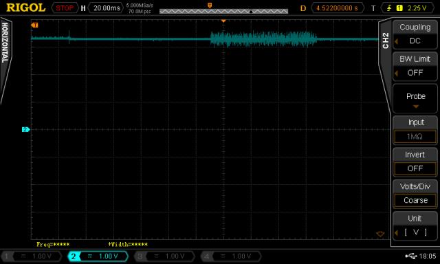

WhiteWizzard - Good thought. I couldn't see a short. Looking at pin 1 on a scope did not seem to show anything awry:
But I did have two blue wires going to a jumper top right on the board, and they ran parallel to the 10k resistor on pin 1, and they carried console transmitted data. I decided to move the jumper elsewhere and get rid of those blue wires. And the problem has gone away. No more tap or flex sensitivity. No more restarting.
Still not totally sure of the cause. But happy it's no longer there.

Finally managed to get a scope on it when it was reliably looping. Pins 13 and 1 ok, but pin 28 (analog V+) had about 1.4 volts of noise on it. This enabled me to find a dry joint between pin 28 and the 3v3 power. Not totally clear why noise on the analog power should affect digital operation of the MM, but it seems it did.
I think it is ok now, but not going to claim that until more testing, in view of false alarm earlier.
