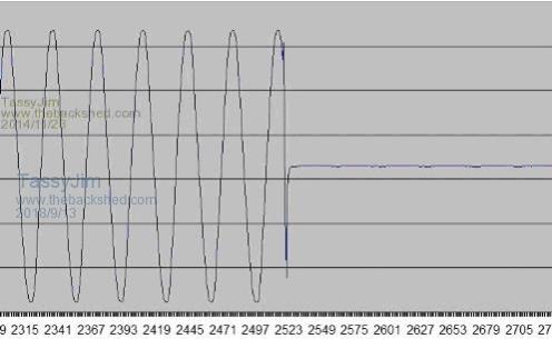

THis is a copy of a post from 2015 describing a disturbance recorder I put together"
Many years ago (everything seems to have happened many years ago), I worked in the power industry and we have some wonderful old instruments. One I liked was a disturbance recorder. Whenever it was triggered, it would spit out a couple of metres of paper with a chart of the voltages and currents for a few seconds before the event and a few seconds after.
Last week I was sitting at the 'puta when there was a power 'disturbance'. I missed the pretty charts so micromite to the rescue.
The idea is to have one micromite continually reading the voltage and when triggered, spit the 5000 readings out to be analyzed.
A MX150 micromite can take 30 readings per 50Hz cycle and a maximum of 5000 readings.
That gives around 3 seconds.
If you trigger it 2 seconds after the 'event', you will end up with 1 second of pre-event and 2 seconds of post-event.
A MX170 can read a bit faster and store more samples.
I will end up triggering from a second micromite similar to Grogster's setup.
If you aren't interested in looking at the AC waveform, use a rectifier and a small filter capacitor then slow the reading rate down.
For the AC input I found an old plug-pack with AC out.
The chart is a portion of a test drawn in Excel.
DIM readings(5000)
SETPIN 5, INTL, snap
SETPIN 4, AIN
n=1
DO
readings(n)=PIN(4)
n = (n+1) MOD 5000
LOOP
END
SUB snap
FOR k = 1 TO 5000
PRINT readings((k+n) MOD 5000)
NEXT k
END SUB
There is no time for the micromite to do any calculations during capture but I am impressed with the quality of the waveform in Excel.
I didn't get past the proof of concept stage but I might revisit it one day.
Note: Analog is deliberately slow on all 'mites due to the multiple readings taken before averaging to increase the effective resolution.
JimEdited by TassyJim 2018-09-14
