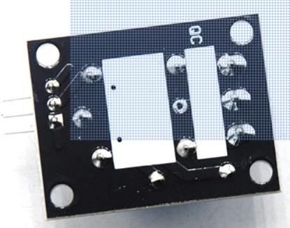

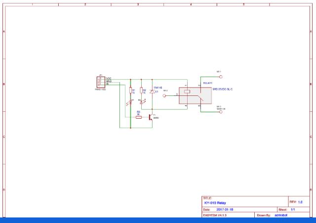

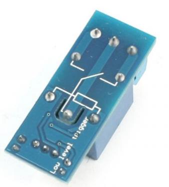

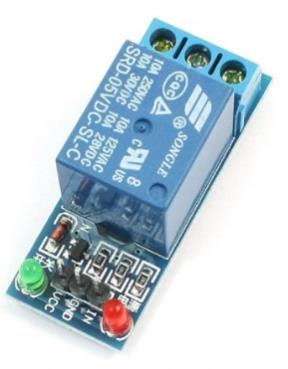

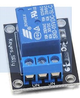

Here is a link to a pdf
KY-019 relay
From the looks of it the Schematic has the transistor E C swapped.
If you have one you could measure Vled and the VBE. You could then adjust
the trip voltage down ward by removing the LED adding more resistance to
keep the current safe for the driving pin.
A bit later found this schematic with same part number at
also KY-019 relay
and in this schematic it looks more like you may able to use a lower voltage.
I couldn't read the transistor number to look it up.
I also noticed that one of do not these have a high voltage slot/gap and with
120/240 AC should be used with caution.
Images of these two KY-019 relays
and
Heres hoping any of this helps.

Quazee137
Joined: 07/08/2016
Posts: 603
Posted: 08:09am 13 Sep 2018
Wrong one for sure.
I grabbed "Re Altronics 10A Relay Modules: Cat. Z6325" thinking it was most
likely the first item you was after. I have been using the sink version of
the 1, 2, 4, 6, 8 and 16 relay modules found on the net. I have to use the
sink version because of pumps, valves and big motors making lots noise.
I have never had a miss fired relay from the noise.
A few of the controllers the MicroMites are replacing had a lot of after
though protection added as they do use a high level to drive the relay portion.
And when your with in a few feet of a monster 3 phase motor things do happen.
With any opto-coupler with status led in line should be able to run at lower
voltage by passing the led "that is if you don't need local indication of status.
