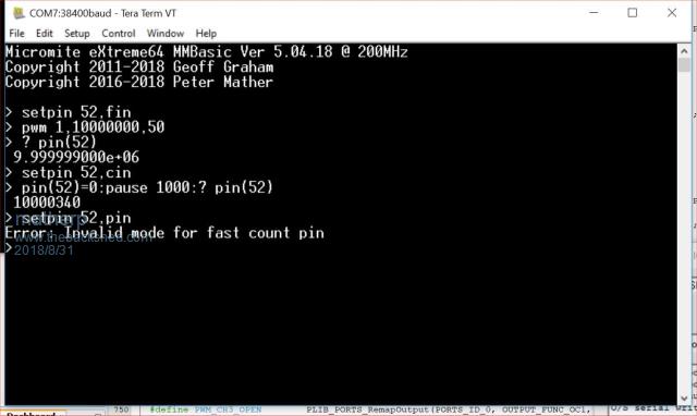

Please find attached version 5.04.18 for the 100/144 pin chips
2018-08-31_022540_MMX5.04.18.zip
and the 64-pin chip
2018-08-31_022618_MMX645.04.18.zip
Manual
2018-08-31_024031_Micromite_eXtreme_Manual.pdf
This version includes various bug fixes as per MM+ 5.04.09 as well as new functionality supporting high speed counter/timer functionality. The idea for this is copied from code I developed for the the Armmite H7 but it works just as nicely on the MMX.
Notice how using the counter mode with a pause gives a slight over-count as the counter continues to increment whilst the pause and print statements are parsed and executed (34 uSec).
PAUSE statements in the MM2 greater than 2 milliseconds can be too short by anything between 0 and 1 milliseconds (0 and 500uSsec for the MM+). The MMX code corrects for this and pause statements will be exact other than the time taken to execute the statement.
Pins for the high speed counter are:
64-pin - 52 'NB conflicts with Mouse data
100-pin - 58 'NB conflicts with COM3-RX
144 pin - 80 'NB conflicts with COM3-RX
