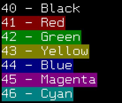

i've not so far provided any way for the user to do so, apart from using ansi escape sequences that would be overriden when starting up the editor or resetting the terminal.

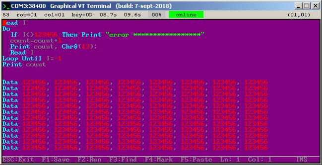

if the background colour were made user settable in the same manner as the foreground colour currently is (by changing the VT default), the selection available would unfortunately be rather boring:
white is excluded as it clashes with the micromite editor's use of dark-white (grey) for some text.
here is a purple example:
would being able to do this be useful to anyone?
note that in order to get a true 'black text on white background' effect, things would become far more complicated - i would have to use an altered colour palette that would mess up any basic programs that used colour themselves. TeraTerm allows altering the colour palette, with often complicated outcomes.
