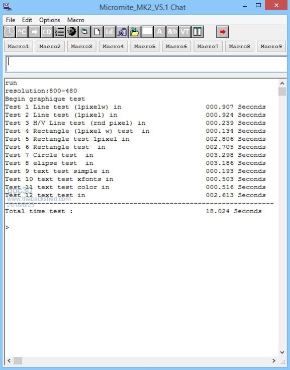

here i post a prog to test some graphiques function on the differents procs who use micromite basic
you can dl here
2018-08-25_135550_test_graph2.zip
this prog give also time for each test
you can put your results here
with type of proc and "option lcdpanel" used
my test for armite with stm32h7
option lcdpanel ssd1963_5_16,rl

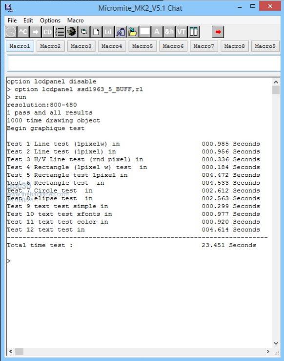

  Quote  my test for armite with stm32h7
Try
option lcdpanel ssd1963_5_BUFF,rl
This writes to a buffer first and then modified areas of the buffer are output to the screen. Some tests may be faster, others slower. The advantage comes when as a user you control when the write comes using OPTION AUTOREFRESH OFF/ON and the REFRESH command. Set OPTION AUTOREFRESH OFF and then run the tests. In this case only the buffer is updated, nothing on the screen unless you put a REFRESH command at the end of each test.Edited by matherp 2018-08-26

Posted: 07:36am 25 Aug 2018
it is more slow in rectangles
i have no tested loading image
goc30
Joined: 12/04/2017
Location: France
Posts: 435
Posted: 07:45am 25 Aug 2018
for loading image, option "buffer" is realy marvelous
very good job
