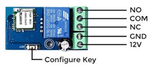

I was sent one of these with a 2 relay module order. They didn't want it back.
So I looked it up and found an app for the phone.
This one wanted my wifi SSID the newtwork password. I may be wrong but it
seemed to me this information was going out the app and over the internet
before reaching the device. Now if it was to the device only that would be fine.
