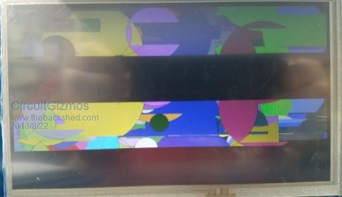

I have a 7" SSD1963 LCD display connected to the Peter Mather Backpack+.
MicroMite+ code I've tried: V5.04.10_Beta, V5.04.09, and V5.04.08.
If I OPTION LCDPANEL SSD1963_7, LANDSCAPE or OPTION LCDPANEL SSD1963_7A, LANDSCAPE and then write to the screen, everything is fine.
If I then OPTION TOUCH 51,33, 50 the screen only displays about 3/4 of what I expect it to display when I write to it.
Anyone see this before? Is anyone set up to reproduce it?

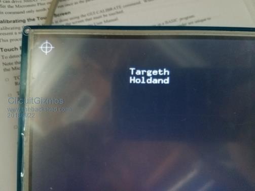

From the image it looks as if the SSD1963 scrolling register is set to a non zero value. This register is set to zero when the LCD is powdered up and is only changed by MMBasic when OPTION LCDPANEL CONSOLE is used and the display needs scrolling.
I don't have any clue as to how it got changed in your case (if indeed this is the issue). The OPTION TOUCH command has nothing to do with the SSD1963 chip.

Thanks, Geoff. It is consistent about working right graphically until the OPTION TOUCH happens.
The GUI TEST LCDPANEL does this:
Note the circles are cut up.

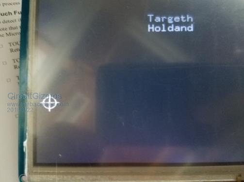

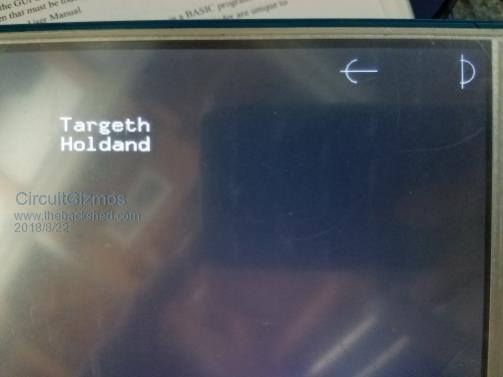

GUI CALIBRATE does this:

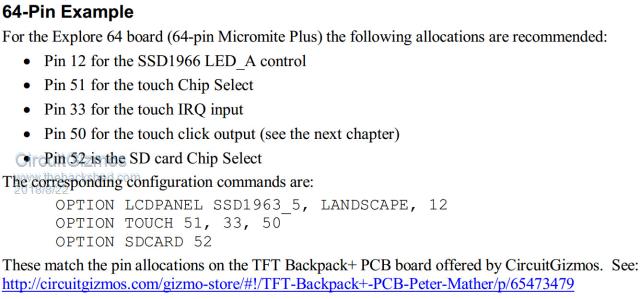

Panky: The options that I followed were from the MM+ manual. I tried your OPTION commands above but it made no difference.
OPTION TOUCH 51,33, 50 in the MM+ manual doesn't seem to be right for the PM Backpack+. Your 42 makes sense.

The pins in the MM+ manual are for the Explore 64 which is different to Peter's Backpack.
Did you try including the option SDCARD suggestion?

These do NOT match the Backpack+. Manual should be changed.

Just like Panky said. The MM+ manual should be updated.Edited by CircuitGizmos 2018-08-23
