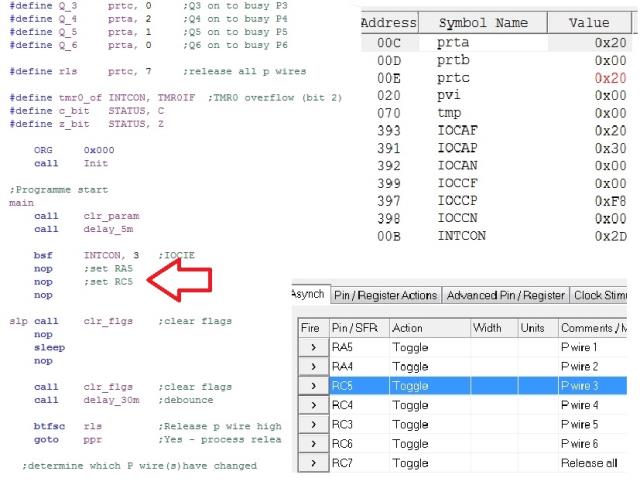

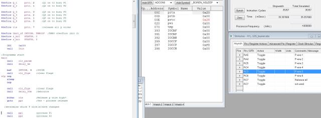

The IOCCF never changes at any stage as you can see in the attachment.
I have to change PORTA to exit from sleep.
I'll programme it into a PIC & see if it works. If so, that will prove my presumption that the MBLAB software is faulty.

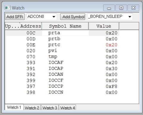

I think I did understand your last point but you may a missed my point. The point I was trying to make is that the IOCCF is always 0 regardless of whether PORTC is changed in sleep or out of sleep. Whereas, the IOCAF changes as expected.
That's why I think it is a MPLAB software fault. I read somewhere that MPLAB 8.92 does not fully support this PIC.
See the attachments.

I did as you suggested in your last point. I inserted some nop statements. I changed PORTA at the first nop & PORTC at the second. The attachment shows the result. IOCAF changed, but not IOCCF.
I made them larger, so I hope you can read it this time.
