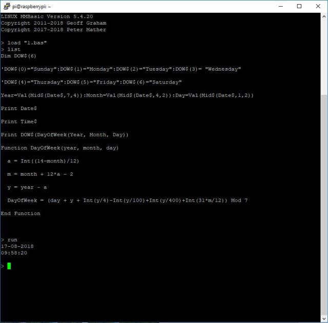

Can anyone tell me why this won't work?
I'm trying to print the day of the week but it always prints Saturday
I've narrowed it down to the month not being processed right
IF I comment out 'DOW$(0)="Sunday":DOW$(1)="Monday":DOW$(2)="Tuesday":DOW$(3)= "Wednesday":'DOW$(4)="Thursday":DOW$(5)="Friday":DOW$(6)="Saturday"
then print DOW$ it prints a blank space
I'm using a Picromite, what I don't get is I've used this code on the Explore 100 in the past and it worked
The only "possible issue" I can see is if I PRINT month$ it prints 8 and not 08 but I can't see that causing an issue
It's probably something stupid I've done but I cannot see what

Posts: 12084
Posted: 08:12am 17 Aug 2018
You haven't dimensioned DOW$
should be
DIM DOW$(6)

Posted: 08:26am 17 Aug 2018
It's still giving the same result

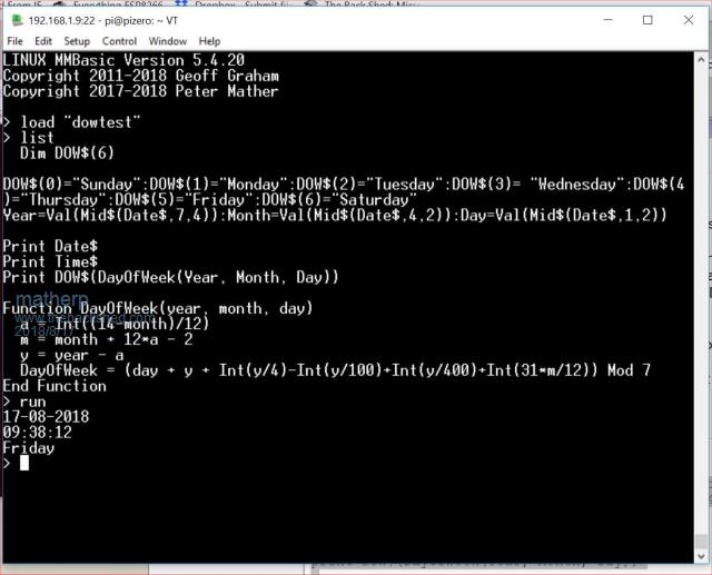

Posts: 12084
Posted: 08:39am 17 Aug 2018
lew247
Joined: 23/12/2015
Posts: 1709
Posted: 08:59am 17 Aug 2018
Peter, how come your's doesn't have spaces in the listing but mine does?
there are no spaces in my code
Edited by lew247 2018-08-18
Posts: 12084
Posted: 09:11am 17 Aug 2018
Your code has CR and LF at the end of lines. Linux expects just CR.
You have commented out the lines setting up DOW$
This is better syntax anyway
DIM DOW$(6)=("Sunday","Monday","Tuesday","Wednesday","Thursday","Friday","Saturday")

Posted: 09:17am 17 Aug 2018
Sorry Peter, I put the comment in when I was trying to find the error and wanted it to print the day numberal
it's working now

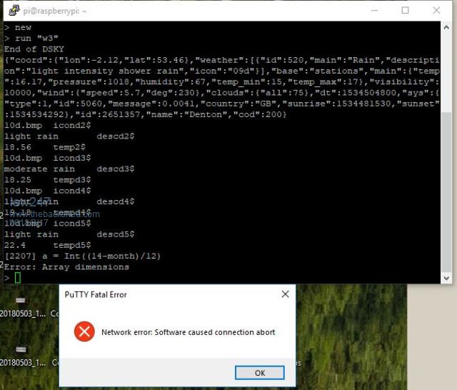

Now it's doing the original problem which is why I tried the DOW function on its own with no program
Now I've integrated it into the program I'm getting this AND the Pi crashes and I have to reboot

Posts: 12084
Posted: 01:44pm 17 Aug 2018
There is a known issue with the Pi-cromite that some, but not many, MMBasic errors cause a crash. I have been unable to track this down as is seems as though it is a compiler and/or linker error.
The problem in your code is almost certainly that the function is returning a negative number or a number > 6 which causes the MMBasic error in the first place

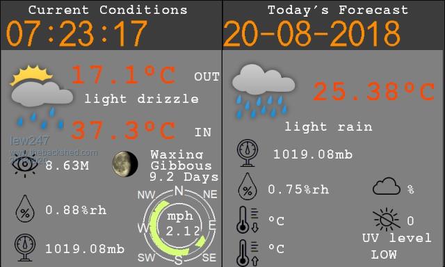

Blit doesn't seem to be working properly?
The "compass" is a picture and the arrow should only be showing one position
Azure

Posts: 12084
Posted: 08:25am 20 Aug 2018
The protocol to make this work is:
write the compass without a pointer
BLIT READ area overlapping the complete compass, i.e. the compass background
do
option autorefresh off ' optional reduces artifacts
BLIT WRITE compass background
write the pointer
option autorefresh on 'optional reduces artifacts
refresh 'optional reduces artifacts
loop
