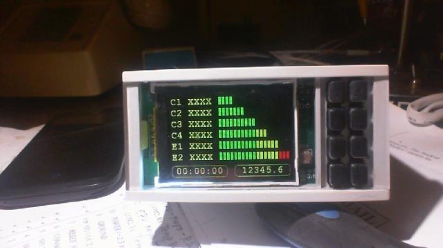

A big thank you Geoff for the addition of the new internal Gauges to the new firmware..! Currently using both types in the DIN panel instrument design for the engine information system I'm trying to get done... Currently using 6 20 segment bar type gauges for CHT ant EGT thermo temps... Will be using the round gauge for RPM... The design uses the 470 MPU...
2018-08-15_201238_DIN_Panel_MPU_Engine.pdf

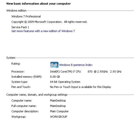

Wow.. Thanks Jim..! I did not know that... Currently using Win 7 here...
I read through the thread you posted, but I am a little confused by it all...
Why does everything work ok until I setup the ILI9341 display..??
I am running the board off of USB power from a powered USB hub..
I can provide external power to see if that works...
I am using the Silicon Chip driver for win 7...
Also, why is it when I go back to v5.04.08 that everything works OK..??
I wasn't planing to "upgrade" this computer to Win-10...
Not sure what the next move should be... I do want to try out v5.04.10 firmware and play with the new GUI bar gauge objects but not sure what my options are to resolve this issue... Thanks in advance for any insight you could provide..!!
EDIT: - Thanks everyone for responding.. I was away for a bit and didn't refresh the page to see the new post entries from Geoff and azure Edited by Zonker 2018-08-20
