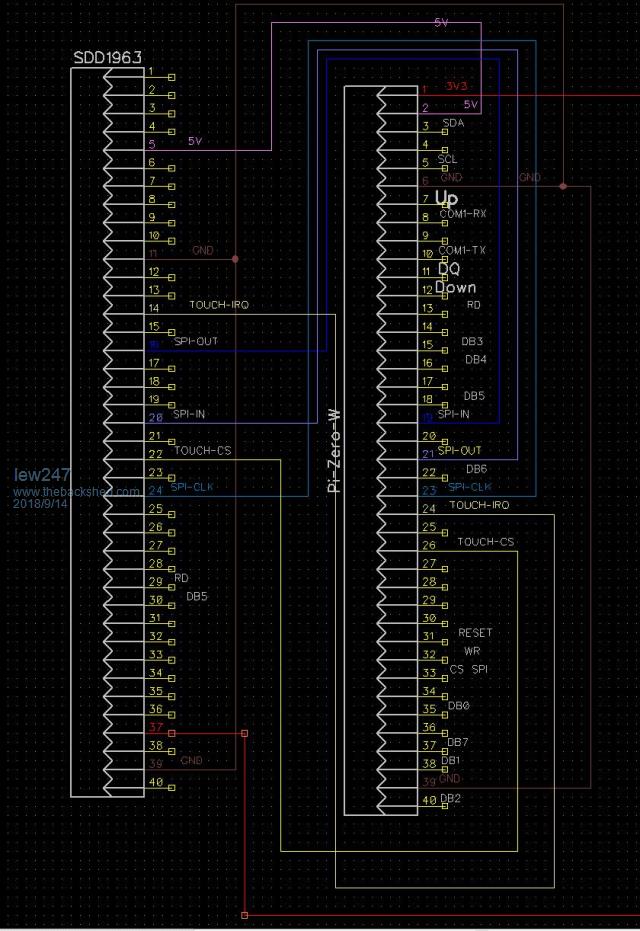

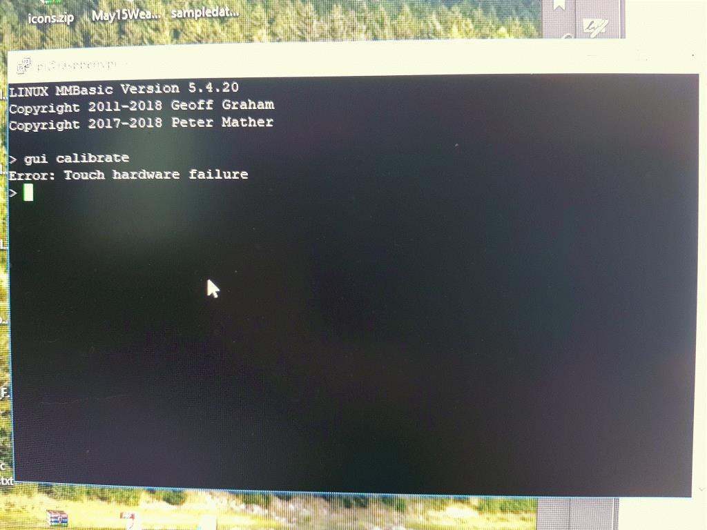

I "think" I've found a bug with the Picromite, it "may" be an error with my soldering but I don't think so
When I attach an SSD1963 display (7 inch) it works ok other than the touch will not calibrate
I thought I'd messed the display up when I tried to move the jumper for the backlight so I bought 2 new ones and both of them are doing the same thing.
I was about give up and get another display when I suddenly had the idea to try calibrating it with my Explore 100 board and it calibrates perfectly with no errors.
This is the error - it appears after touching the 2nd touch point in the calibrate routine
btw IF this is an error and do release an updated version, any chance of the gauges that are in the latest MM test version? they look really simple to implement for someone as useless at programming as me

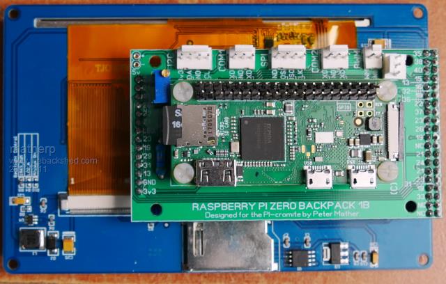

Just tested 5.4.20 on a Pi-Zero and it works fine. I'm using Grogster's backpack to connect the display:
Option lcdpanel SSD1963_5,l,,36
Option touch 26,24
Will include the new controls when Geoff releases the source at the end of the beta period

I just redownloaded 5.4.20 in case I was using an older version and reinstalled it
Deleted the Options file
and when I go to calibrate the touch I still get the same error

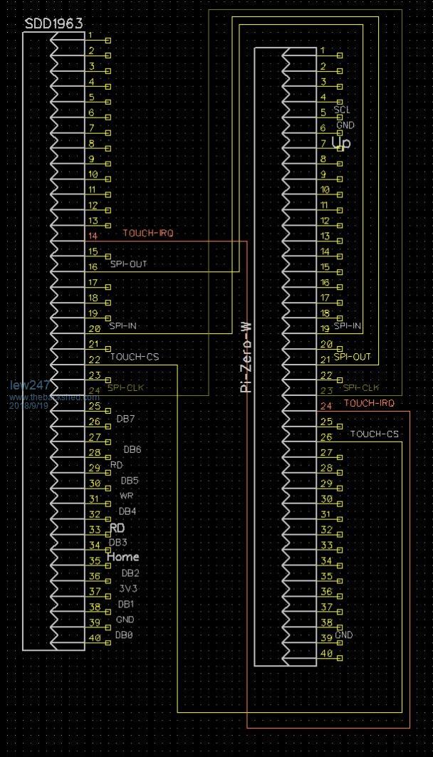

This is the relevant part of the circuit and I'm pretty sure it's correct
Posts: 12084
Posted: 01:14pm 10 Aug 2018
16 is T_DO which should be connected to SPI_IN
20 is T_DIN which should be connected to SPI_OUT

According to the manual
21 DIGITAL_IN DIGITAL_OUT SPI-IN
19 DIGITAL_IN DIGITAL_OUT SPI-OUT
On the SSD1963
pin 16 T_DO is connected to pin 19 on the Picromite
pin 20 T_DIN is connected to pin 21 on the Picromite
so it should be working
Posts: 12084
Posted: 03:07pm 10 Aug 2018
  Quote  so it should be working
If it was right it would be working
T_DO (pin 16 of the SSD1963 in your diagram) is the output of the touch controller it connects to SPI-IN
T_DIN (pin 20 of the SSD1963 in your diagram) is the input to the touch controller it connects to SPI-OUT
Your diagram above is incorrect - the signals are swapped. Check Grogster's PCB which is correct

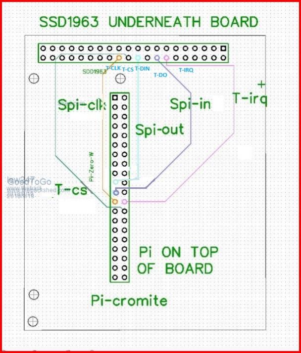

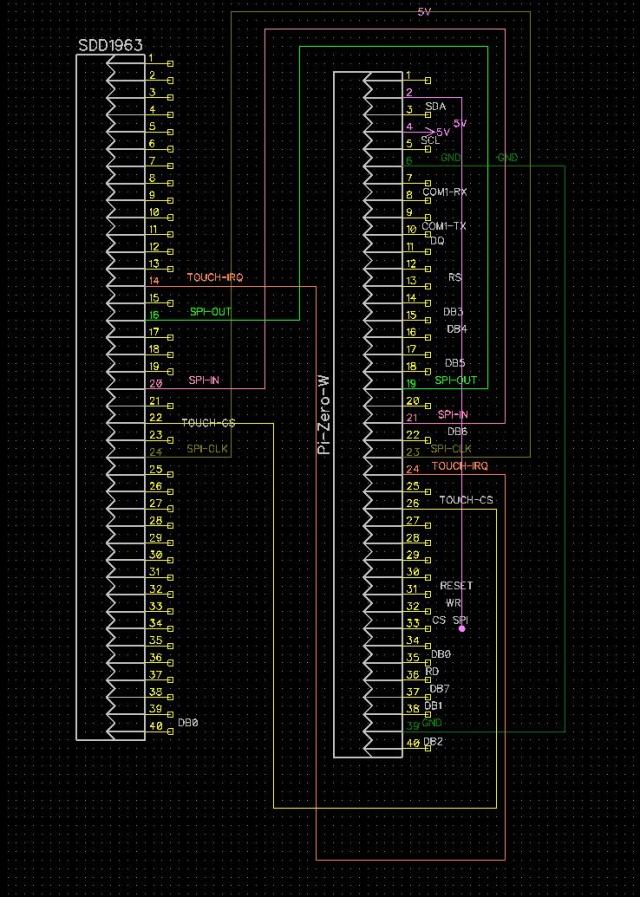

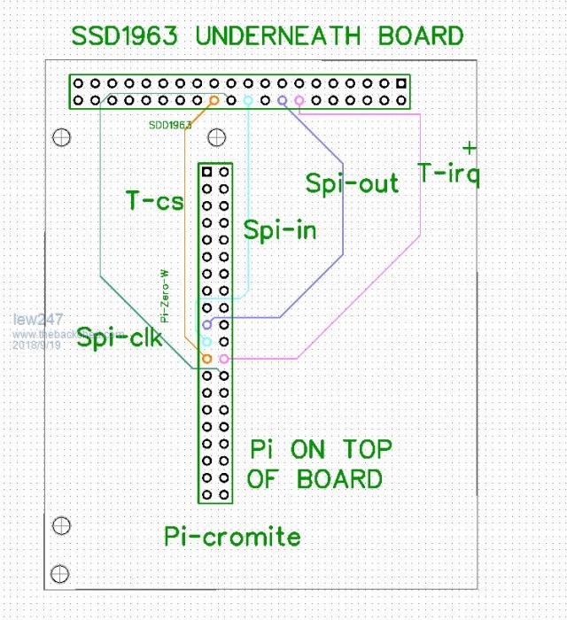

I've just soldered up a new board and I'm convinced I have the pins correct but I'm still getting the exact same "Hardware Failure" when I try calibrating the touch
The top 2 calibration points calibrate perfectly, it's when I touch the 3rd point I get the error
Could anyone check this circuit and tell me if it's correct please?
Frank N. Furter
Joined: 28/05/2012
Posts: 1162
Posted: 10:11am 14 Sep 2018
It seems that you confused SPI-IN and SPI-OUT on the Raspberry side:
You have SPI-IN on 19 and SPI-OUT on 21...
Frank
Posts: 12084
Posted: 10:27am 14 Sep 2018
  Quote  It seems that you confused SPI-IN and SPI-OUT on the Raspberry side:
Not sure, the problem is that the diagram shows the connectors as SIL whereas they are both DIL so it is very difficult to check properly
As I said before the best thing is to exactly copy Grogster's board which is correct.
T-CLK connects to Picromite pin 23
T-CS connects to Picromite pin 26
T-DIN connects to Picromite pin 19
T-DO connects to Picromite pin 21
t-IRQ connects to Picromite pin 24
Then OPTION TOUCH 26,24

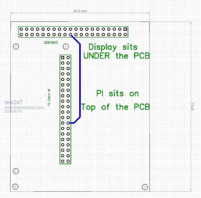

lew247
Joined: 23/12/2015
Posts: 1709
Posted: 11:24am 14 Sep 2018
The connectors are just the ones I found on Diptrace
They are the correct connectors on the board and everything else works perfectly
The touch even works when calibrating PARTLY
the first 2 calibration points work
When touching the 3rd point that's when I get the "Hardware Failure" message
I would have thought if I had the pins wrong then touch wouldn't work at all?

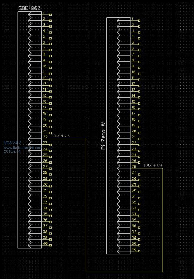

Posts: 12084
Posted: 11:55am 14 Sep 2018
  Quote  I would have thought if I had the pins wrong then touch wouldn't work at all?
No, you get exactly this result if the T_CS pin is not connected
lew247
Joined: 23/12/2015
Posts: 1709
Posted: 12:35pm 14 Sep 2018
I got rid of every other trace, leaving only the T_CS showing it is connected to Pin 26
and the reason I didn't copy Grogsters board is because it didn't have things I needed on it.
Although I deleted the track in error before i took the screen shot, the SPI OUT on the Picromite board IS connected to the SPI IN on the display, as is the SPI IN on the board connected to the SPI OUT on the display
Board layout with ONLY the T_CS pin connected
Edited by lew247 2018-09-16
lew247
Joined: 23/12/2015
Posts: 1709
Posted: 10:23pm 18 Sep 2018
Can anyone tell me exactly which wire/trace is in the wrong position please?
Display sitting underneath the board, and the Pi-Zero-W sits on top of the board
disco4now
Joined: 18/12/2014
Posts: 1159
Posted: 10:37pm 18 Sep 2018
Hi Lewis,
Seems OK to me. Have you tried unplugging everything and checking for shorts between the relevant adjacent pins, esp T_CS and T_IRQ to to anything else.
Maybe also do
OPTION LIST
and double check the Touch
is
OPTION TOUCH 26,24Edited by disco4now 2018-09-20
