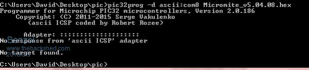

I am trying to upload the newest version of the Micromite firmware to an old Micromite via the Backpack V2.
I keep getting the following message;
Can anyone offer a suggestion as to what has gone wrong?

Have you pressed the MODE button before trying to upgrade the firmware?
In normal mode, the 1455 on the backpack will operate as a serial connection.
You have to put it into programming mode, by pressing the MODE button once - the LED just above the USB socket will light and stay on to indicate it is ready to accept a new program.
If you DON'T put the 1455 into programming mode, you will most definitely get that error. Edited by Grogster 2018-08-10

AWESOME Grogs
Thank you.
That's mentioned in the SC article on the Microbridge but the specifics are not in the Backpack article.
