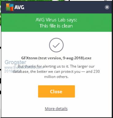

On another subject, AVG labs have reported your file as clean.
We all knew it would have been, but it is always nice to get the confirmation. Edited by Grogster 2018-08-12
