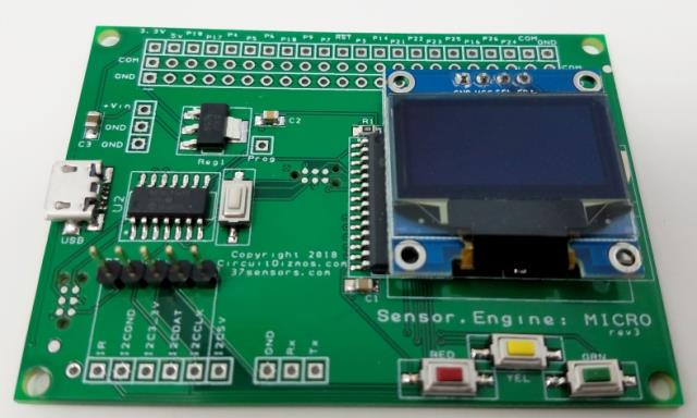

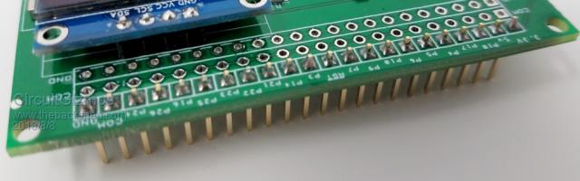

Here is the board that I designed for David. This is the Sensor.Engine:MICRO and the idea behind this board is to make a MicroMite aimed at STEM education and hobby experimentation.

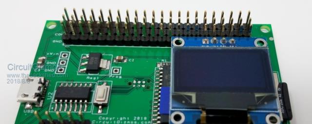

This is a 28 pin MM. Most pins are available on the top edge. The top edge can be populated with pins pointed upward:
Pins up makes it easy to use female "Dupont" jumpers. Like these:

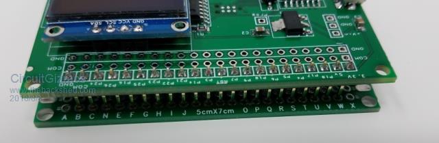

Pins down can also be dropped onto a sea-of-holes prototype board:

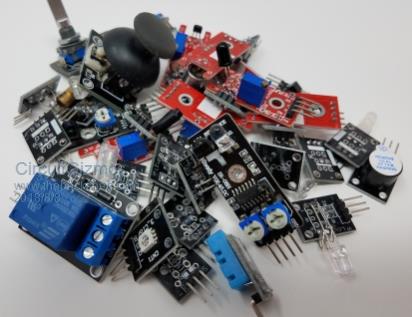

The goal is to make it easy to make sensor projects out of the 37 sensor kits:

The display is 64x128 I2C. Driver is already loaded into the library space.
The interface is via USB, and the console lines are still available.
There is an analog reference onboard.
Top row pinout:
Bottom row is all ground.
Middle row is called "common" and can be jumpered to 3.3V or 5.0V or externally to a voltage.
SD card is push-in and push-out. SD card can be used to log data. The basic file routines are in the library flash.
Three buttons round out the hardware.

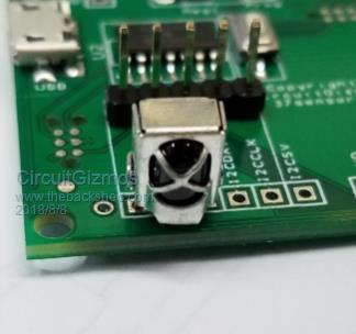

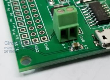

Alternate power input:
IR receiver support:

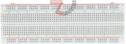

Posted: 06:37pm 08 Aug 2018
This type would be my preference for breadboard.
Perhaps a jumper to select either 3V3 or 5V would be good.

Posted: 06:09am 09 Aug 2018
  lizby said   This type would be my preference for breadboard.
MB-102 830 points.
very popular/common format - Search ebay for MB102 and look at the masses of stuff that comes back. A lot are from Chinese manufacturers and can be a bit stiff to insert wires, but they are cheap and plentiful.
I standardized all my breadboards on this format Edited by CaptainBoing 2018-08-10

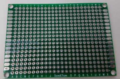

On a related note, why on Earth are these boards marked like this?
