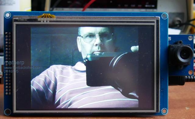

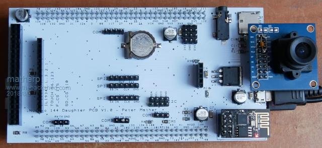

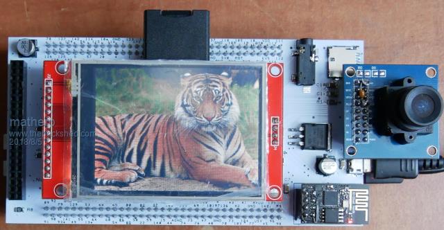

Patch wiring lots of cable to displays, camera etc. is painful and open to error so I have developed a backpack to allow connection to the Nucleo 144 of various peripherals.

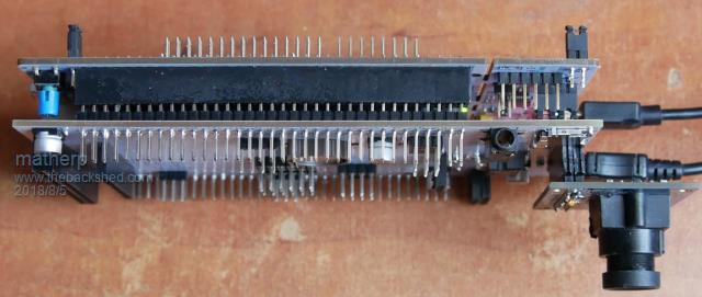

It supports ILI9341, SSD1963, OV7670 camera, ESP8266 module (Com3), battery for RTC, audio output socket, as well as dedicated ports for Com1, Com2, Com3, Com4, SPI1, SPI2, SPI3, and I2C. I've used tall headers so all the Nucleo pins are also available.
This first version included an SDcard slot for the 4-bit parallel interface which I have now scrapped but the SDcard slot on the displays can be used. The attached gerbers have the SDcard slot connected using SPI.

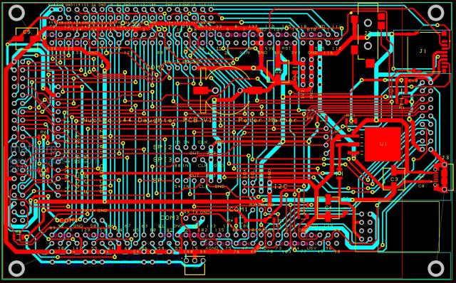

I decided it would be good idea to increase the size of the backpack to allow the 5" SSD1963 display to be mounted properly. As this gave me more real estate I've also included a Raspberry Pi style header which will allow Pi HATs such as ILI9481 style displays to be plugged in. I've also added an optional IR receiver and optional pullups on 8 I/O lines for things like DS18B20. This is then Version 1.3. As always comments appreciated. Ground planes are removed for ease of inspection.
I've checked COM4 RX and TX on the Nucleo Arduino header and they are definitely the correct way round in the latest release of the firmware - someone suggested there may be an issue.
