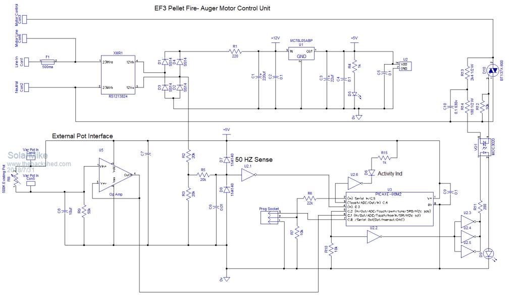

Wouldn't you know it, here we are in the middle of winter (NZ) and the bloody wood burner has stopped working, its full of electronics, potted blue modules and lots of odd colored mains voltage wires running every where. When I purchased the thing second hand about 8 years ago, I thought it had better not crap out, getting parts would be a nightmare.
This model is no longer current, newer ones have a big cpu board, this one has what looks like off the shelf potted modules that are Timers, Pulses, Fan speed controls, mechanical heat switches, which probably are easier to replicate than the later versions. Well there is a module that connects to a front panel 470K variable pot and pulses the motor that drives the auger that sends pellets into the burn chamber, and its very intermittent; almost dead, the pot is fine. These modules are available on order at near $200 which is a ripoff, and obviously they can blow up, so why would I buy one.
Having used the fire a lot, I know pretty much how long the motor runs for and its on/off cycle duration's as the front panel knob is turned, so figured I would build a replacement, using an 8 pin Picaxe and a few components costing about $20. Here is a circuit, pretty basic but should work. U2 value not shown is a 74HC14 Schmidt trigger to sense mains zero crossings, the op-amp buffers the high value pot input to low impedance source voltage for the cpu's adc input. Motor has a 1 second on period with variable off between fully off then stepped to 8 and 2 seconds duration as the pot is turned to set the heat output. Could have almost done this with 555 timers....

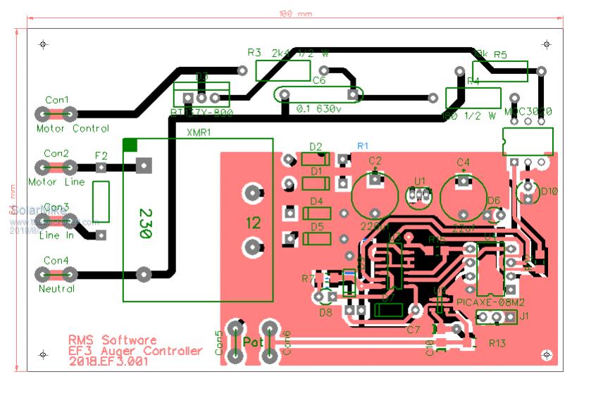

PCB, quick diy job here, not worth it to send it off to Fab house, have to get this built before the next cold snap.
