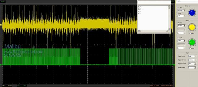

It took a few tries to get a capture, but this is perfect to explain what my question is...
Top trace is the voltage/signal across the current sense resistor on the DRV8825.
Bottom trace is the step input pulse from the MM.
The MM Chat window is open so I can see what stage the loop is in.
So, step mode has just gone from 1/4 to 1/2 on this capture, but right at the end of the 1/4 mode, the step pulses from the MM drop out completely (hard to see how many pulse are missing, but there's a lot). You can see by the 'patterns' on the top trace to the motor what the result is when the steps drop out.
This is a random occurance, and only seems to happen during the ramp-up part of it, and at any step mode condition, but not while there is a set speed. The stepper has been happily running for 20 minutes now on a set speed (in full step mode)
Sorry for the poor picture - it's a screen capture of a screen recording that was around 3 minutes long, and this was the clearest example on it.
So, any ideas on what I'm doing wrong this time?

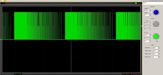

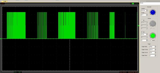

As you say, it's around 100mS (closer to around 90mS by the looks of it), but it's still there.
As an observation, it only seems to happen:
A) On ramp up timing
B) On the lower frequencies
C) Again, with no regular position or amount of times.
On saying it's 100ms second timing, it may be happening on a shorter Hz count, but my crappy DSO setup is just missing some of the skips and they might be happening too quick to have a noticeable effect on the RPM's.
Is it possible that the "PAUSE" statements are causing the PWM to hang?

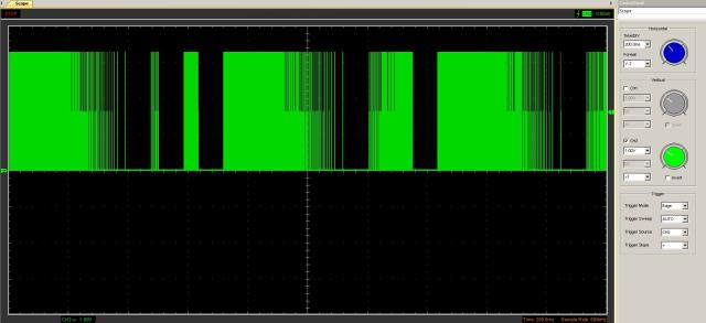

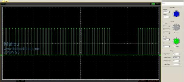

So, with the RAMP UP code commented out (ie: only ramping down), here's the results.
A nice and clean, sweeping waveform that makes sense...
Comment out the RAMP DOWN code, and only run the RAMP UP and here's what happens.
Looks like it's only on a frequency increase...
So, here's the full code running...
None of these DSO grabs have the DRV8825 board in place (and by default, the motor isn't running)
When I first got this glitch I was pretty sure it was a hardware and/or wiring fault, or maybe I'm losing my marbles - but I'm starting to think it's neither...
