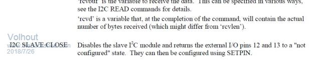

Hi GOC30,
In the manual it says you can use master and slave functions simultaneous on micromite B. It makes life pretty complicated though. Since you have to arbiter in software when what happens. Your later test with 2 slaves and one master is so much easier.
There is a small leftover of the maximite manual in the micromite manual (result of RTFM....). It confuses with pins 12 and 13....
