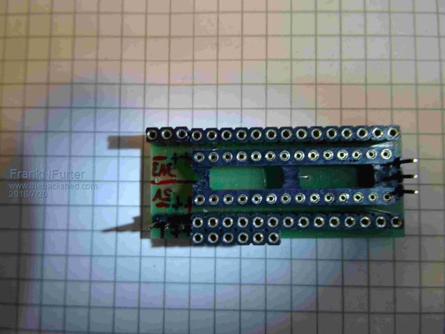

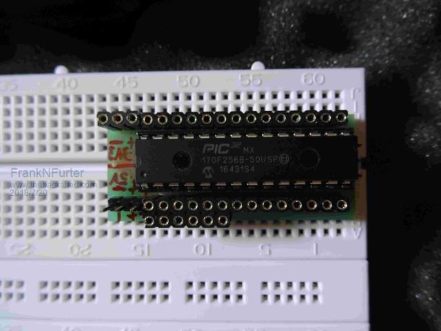

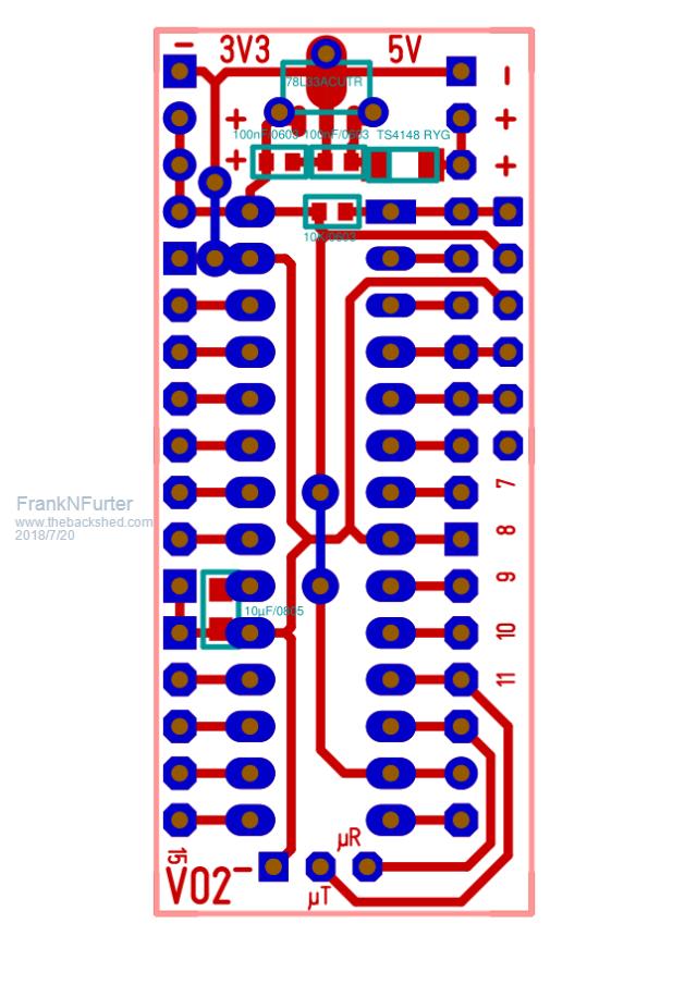

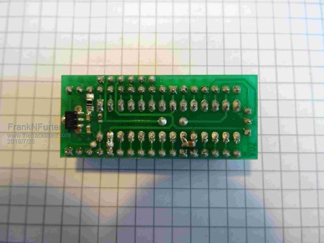

I want to share my little SimpleMite project with you. I developed this one-sided board to quickly test something with the MicroMite.
It can be equipped with an SMD 78L33ACUTR or a THT LT1121CZ-3.3.
You need only two wire bridges on the TOP
...all other components are on the BOT...

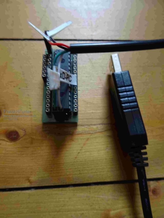

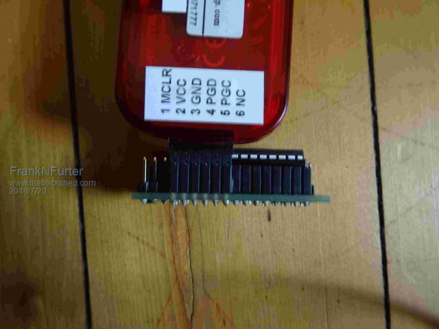

You can program it directly with a PICKit3 without external power supply:

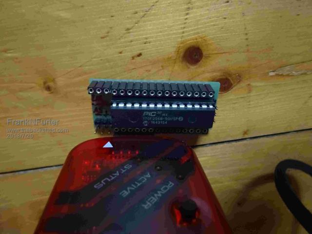

...and you can use it with a USB-SERIAL dongle (like PL2303)...
...it's breadboard friendly when you solder longer pins
All pins are led out and the console can be connected directly.
I have no PCB's to sell, but here are the Gerberfiles:2018-07-20_190306_SimpleMite_Gerber.zip

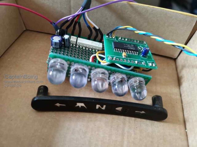

Posted: 01:40pm 20 Jul 2018
@Frank N. Furter
here's a Mk1 going in a Harley Davidson FDX on Monday.
