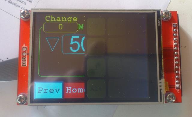

Not sure what I've done here, but I have weird things happening when I use the GUI Numberbox...
Around 75% of the time it seems to do what it's supposed to, but sometimes it plays up. If I touch the NumberBox area on my screen, the background dims and highlights the numberbox area - but NOT show the actual 'keypad' on the screen. The numbers will work and I can enter a number (say "123") by 'guessing' where the numbers are located. As I enter each numeral, the number keys then show in full brightness (only the numbers I hit)
By this time, if I select the "enter" key to finish up, the number is displayed on the numberbox area, the screen goes back to full brightness, but the keypad is shown ghosted and hides everything under it....
Here's the code that I'm trying to use
gui NumberBox #64, 20,20,100,30,cYellow,cBlack
and I'm using an MM+E 64 with an ILI9341 screen
None of the other GUI controls seem to be a problem and here's a picture of what I'm blathering about...
It's got me baffled, so any pointers to what I've done wrong would be appreciated

What version of MMBasic are you using?
In the current beta (V5.04.10 beta 2 and 3) I messed around with the NUMBERBOX code so something could have gone wrong. But nothing was touched in previous versions so they should be OK.
The randomness of the occurrence is a worry. That points to degradation of the signal to the LCD panel or the power supply. Do you have anything loading down the SPI bus. Final thing to check is your power supply. Try a solid lab supply, not a USB charger (these have very noisy outputs).Edited by Geoffg 2018-07-13
