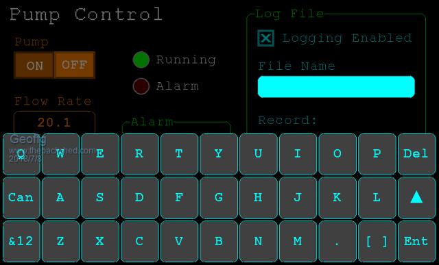

Another day, another beta (V5.04.10 Beta 2). You can download it from: http://geoffg.net/micromite.html
This version has a revised keyboard layout for the GUI TEXTBOX as per Grogster's suggestion. I have added an extra three keys down the right hand side and that allows for the addition of a number of permanent keys that are available on every layout of the keyboard. These are the delete/backspace key, the cancel key, and period (".").
To squeeze in the extra keys I made each key slightly narrower and reduced the space between keys. The result still looks OK (to my eyes at least). While doing this I realised why the original keyboard was 10 keys wide. With an 800 pixel wide screen each key was 80 pixels however with 11 keys wide each key now occupies 72.727 pixels and that fraction of a pixel was a real pain to deal with.
I would be grateful if people could play with this as I am anxious to find out if the new layout has broken anyone's program.
