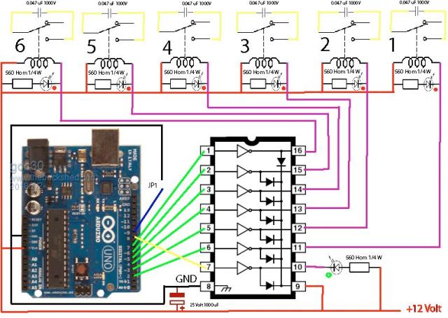

Hi louis
  LouisG said   Thanks Goc.
I thought of a DIL relay driving a higher power relay but it seems there are no 3.3V relays for direct connection to the Micromite. There are 5V ones but then I would be back to open collector operation.
Louis

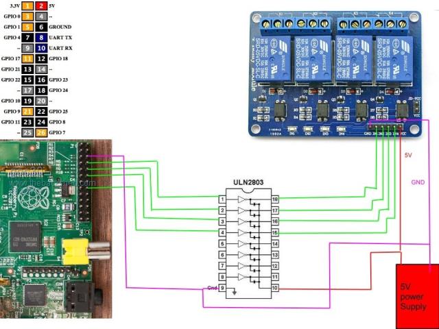

you can use an ULN2803a. It is a Darlington transistor driver. It can output 500ma in 12v
Edited by goc30 2018-07-03

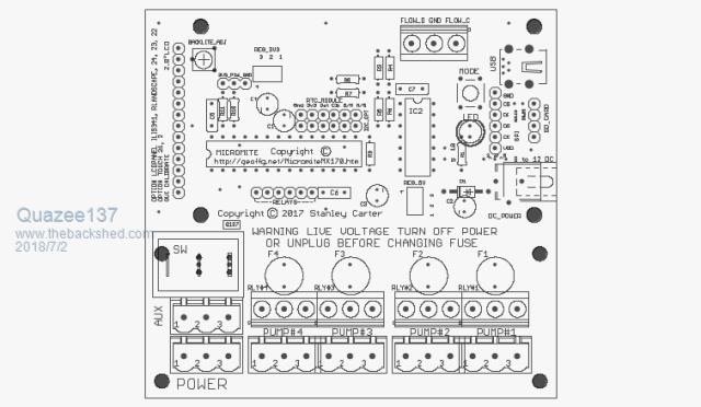

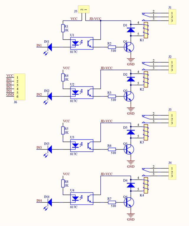

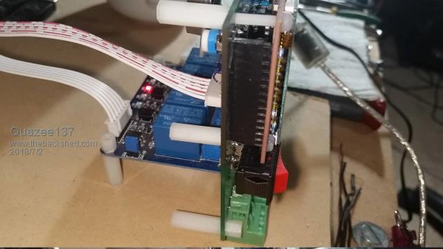

I am driving the quad relay boards from the 170 with no problems.
Using pins 6,7,10,11 as a port. The only problem was the LM1117-MP5.0
was going into thermal shutdown "I was pulling 600mA" total.
The fix was a 6 volt supply instead of the 12.
Just checked and it a bit over 2mA on the mites pins.
You have 5v going to 1k and 2 leds. The relays need about 90mA each.Edited by Quazee137 2018-07-03

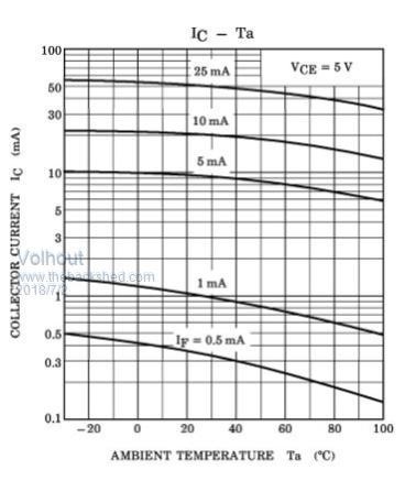

I have no idea how your high side switch circuit would look, but driving 2 LED's in parallel is technically possible from the micromite.
The TLP521 you plan to use has specified behaviour over a wide temperature range, if diven from 0.5mA. On a 3.3V output of a micromite, that would mean a series resistor of 4.7k or 4.3k.
If you use a similar current for your indicator LED that would limit the current per pin to a total of 1mA, perfectly fine, even if 32 are ON at the same time.
Nowadays high efficiency LED's that give sufficient brightness at 1mA and below are easy to find. If they are available in LED BAR's I don't know. The LED bars are somthing a bit more 80's and 90's style, and then high efficiency LED's did not exist.
For the optocouplers driven at 0.5mA, you have to accept that at higher temperatures they only output 0.1mA. So you driver (FET or BJT) has only 0.1mA GATE/BASE current.
A darlington may not be sufficient .... especially not for the 13 watt valve. You would need an extra amplifier stage or use a FET).
See attached graph.
Edited by Volhout 2018-07-03

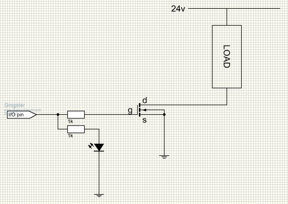

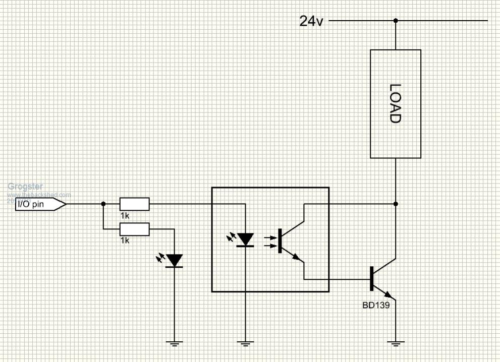

Posts: 10077
Posted: 11:13pm 02 Jul 2018
My first thought is this:
That's about as simple as you can get with bi-polars, but still allowing you to switch a reasonable current on each of the outputs, and have an LED for each one. The circuit could be simplified if you just had a MOSFET output, and you would not even really need the opto-coupler, as the gate of a MOSFET is totally isolated from the source-drain path anyway:
You just have to be a bit more careful when selecting the MOSFET to make sure it can handle the 24v and the load you want to put on it, and also that the Vgs(voltage between gate and source) is within spec. If all that jives, you are away laughing and no opto-coupler needed at all. But you still have your isolation, because the gate is isolated in a MOSFET, and there is no gate current to speak of unlike the base-emitter current in a bi-polar.Edited by Grogster 2018-07-04

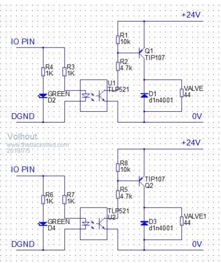

Posts: 6209
Posted: 09:33am 03 Jul 2018
Dear Grogster,
Please understand that a high side switch is needed because the load he is driving is connected to ground. So both proposals need to be adapted to that.

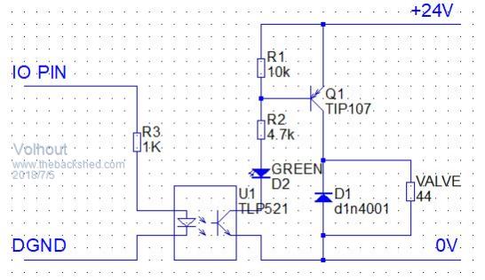

As for the optocoupler solution, you are drawing (assume 3.3V from micromite) 2mA for the optocoupler and 2 mA for the LED (1k resistors). That is 4 mA per pin. With 32 outputs that will be 128mA IO current only.
Most likely this will work (max 200mA in Vss or Vdd pin).
Over temperature you can drive roughly 0.8mA into the base of that BD139.
If you would do high side drive, it would be a BD140 most likely.
If the load is 13 watt at 24V, that is 550mA. At 550mA the current gain of the BD140 is 70. Meaning that you cazn switch (base current * current gain) = 0.8mA * 70 = 56mA.
That is far below the 550mA needed.
So a BD140 will not do it. You most likely need a darlington (as in the first post).
As for the FET proposal: Yes a gate of a FET is isolated. But the maximum voltage between the gate and other pins of the FET is typically 20-30V....
And this voltage determins if the FET is ON or OFF. Meaning the isolation will conflit with the operation of the FET..
What I learned from this excersize is that we can drive the opto coupler harder than 0.5mA, giving us more power to drive the power switch. So the solution with a darlington may be feasible after all.
A dalington has a gain of 800 or more (not 70), so with 0.8mA drive current from the opto coupler it would most likely switch fine at 13 watt load.
In fact, you have your circuit ready.....

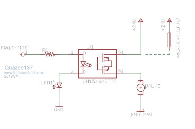

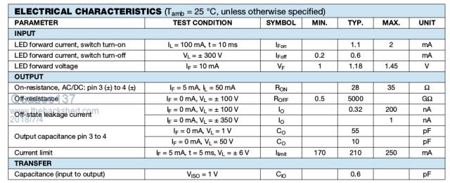

It's not the opto you wanted but it may make things easier.
At mouser and digi-key
LH1546ADFT 24@$31.92 25@$37.62
I have a few left over from a project and it works with the chip
leds I use but I dont have the bar display to test.

Dear Quazee137,
Nice opto's. Would work very well for driving (small) relays from 24V.
Tread starter however talked about 13 watt load.
That is not for the faint of heart.
13 watt at 24V is 550mA or 44 ohm resistance.
The opto couplers you mention have 28 ohm internal resistance (at 5mA drive, not 2mA).
total resistance (load + switch) would total up to 44 + 28 = 72 ohm
That would limit the current to 24V / 72ohm = 330mA
Although that may be enough to drive the 13 watt load (marginal, but might "just" work), it means the opto coupler dissipates I2R = .333*.333*28 - 2.8 watt.
Thermal meltdown....
But a good solution for smaller outputs (up to 100mA or so).

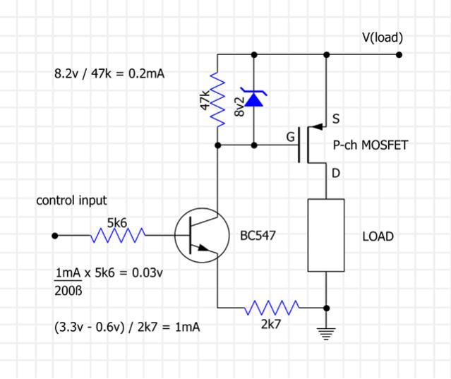

for high-side switching, use the following with a large P-channel mosfet:
the BC547 and 2k7 resistor create a 1mA constant-current sink when the control input is high (3v3). along with the 8v2 zener diode this creates the gate voltage for the P-channel mosfet, limited to 8v2 to prevent exceeding the mosfet's Vgs(max).
the 47k resistor ensures the mosfet turns off when the control input is low (hence minimal collector current through the BC547). meanwhile, the 5k6 resistor is included in case of V(load) being absent for some reason, limiting the current drawn from the control input to a few hundred microamps.
V(load) is only limited by the rating of the mosfet and the Vce(max) of the BC547.
if you wish to include an indicator LED, you could:
1. insert it between the collector of the BC547 and the gate of the mosfet, or,
2. insert it in series with the zener diode (and lower the zener's voltage to compensate), or,
3. connect it from the base of the BC547 to ground and adjust the 5k6 and 2k7 resistors accordingly.

Thanks a lot, Rob.
I assume the phototransistor of the photocoupler can be substituted for the BC547. I'll breadboard a circuit to verify.
Louis

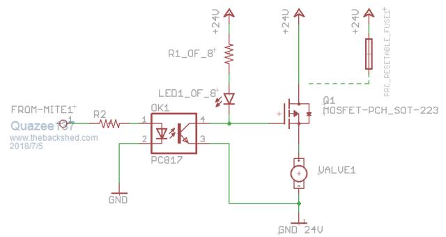

Quazee137
Joined: 07/08/2016
Posts: 603
Posted: 02:24am 05 Jul 2018

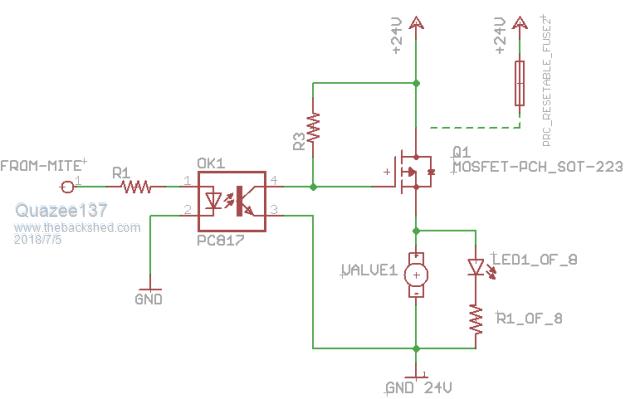

Just a basic thoughts.
Edited by Quazee137 2018-07-06
