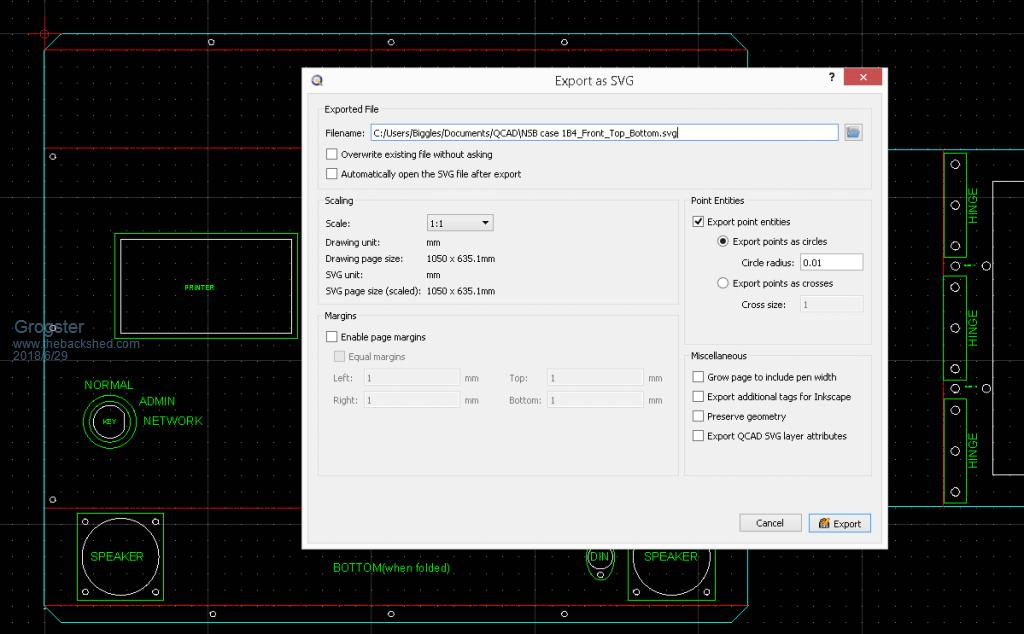

OK, purchased QCAD for US$40 or so, and when I did that, they offered the E-book of some 276 pages for only 12 Euro more, so I added that too.(normal price is 30 Euro for the E-book) I am sure the book will come in handy.
@ MB: Here is the 'Advanced SVG export' option....

Posted: 08:31am 29 Jun 2018
Looks ok. I would deselect 'Export point entities'. Points do not have any diameter or width anyway.
Lines also should be without a line width.
A laser cutter has a kerf of about 0.2mm. If you need very tight fits then you will have to do some tests. For example a 8mm hole will end up being 8.2mm. Most of the time not a problem, but if it is you need to adjust for it by shrinking the diameter with 0.2mm.
This changes with every lasercutter and even with the same machine it changes when using different speeds and power settings.
Extruded acrylic is a more consistent and cuts easier and leaves a nice edge.
Colored acrylics however are often cast and this has more variances in thickness.
For instance a 3mm thick sheet can be anywhere between 2.5 and 3mm. Sometimes you have to keep this in mind when it needs to be tight fitting in thickness.
