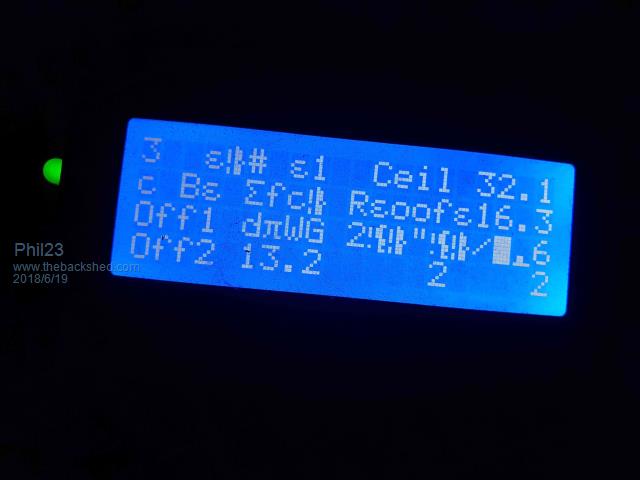

Every so often I'm getting a corrupted LCD display on my heat controller.
The code in the MM is still running fine if I check at the console & a reboot or Ctrl-C & run again fixes it, but it's obviously annoying...

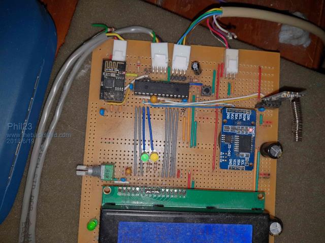

Cables coming from the board got to a string of DS18B20's on the left plug & the other two (3) got to 2x 4 gang relay boards up in the roof.

I see you have a couple of electro caps on the board. Being Veroboard the actual signal/voltage at the component pin may fluctuate from what you would expect.
If you have an oscilloscope you can check the noise on the 5v directly at the LCD while it is running. Possible some ripple or HF noise effecting it. It would pay while you are doing that to also check the control and data signals at the LCD to make sure they are also nice and clean.
You should try and monitor the signals during worst case conditions, when relays are switched and when the wireless unit is transmitting/receiving.

My suspicions would be firstly around power quality at LCD from noise or excessive ripple or dips during certain operations on power lines at LCD. If you can't check it and just want to try things a 100uF/220uF electro and a 0.1uf ceramic wired close to the LCD power pins may help clean up and stabilise the power at the LCD.
The WiFi board is probably the biggest power consumer during transmission after the relay board.
The Control and Data lines really need a scope on them to see if they are clean. On your board it looks like they are wired in fairly directly so they should be ok.

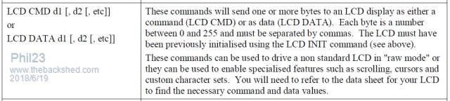

Just tried breaking to a prompt when I had just two characters of corruption,
sent in LCD CMD &h30 & it cleared the 2nd & 4th line & put more gobbly gook in lines 1 & 3.
Tried LCD 1,1,"hello" after that with no response.
Should have tried "hello" in a few places first, to see if it was still operational, as I'm assuming it's not, cause if it was each re-write should get rid of the corruption.
Need to find a list of the valid commands...
