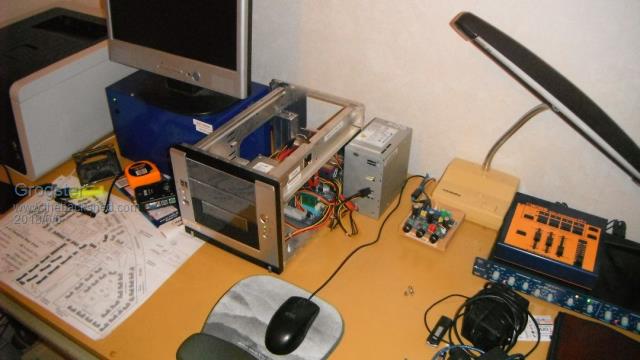

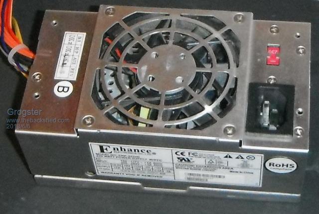

I have recently had an issue with a PC PSU that was somewhat strange looking. I fixed it by just using a standard PSU on the outside of the case. Not very cute, but it does work fine.
Original PSU:
My way around this issue:
As I say - not attractive, but it works!
