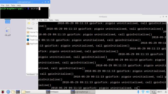

I've been through this before, but forgotten.....
Mmbasic opens (sorta),but I get the screen above scrolling down fast.
I have :
folder named basic in /pi/home/ with mmbasic inside
mmbasic permissions changed to anyone

hi
have you delete file "options" .it is an hidden file in same folder than mmbasic exec

  goc30 said   hi
Yes .

Make sure there are no other versions of mmbasic still running (reboot).
Don't use/run the pigpio daemon. make sure it isn't running
run mmbasic with sudo (sudo ./mmbasic)

Posted: 05:16pm 30 May 2018
Thanks !
The "sudo" did it.
