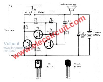

I had something similar to THIS in my house for years.
small box with speaker (that also acts as microphone) and button
You don't need to ring first, just say the word.. and you are heard everywhere in the house.

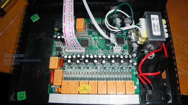

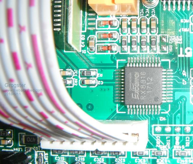

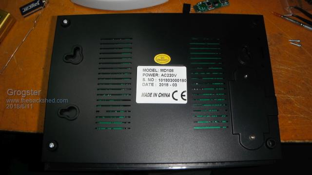

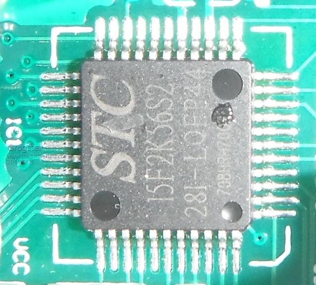

Photos of inside and outside:
Transformer based PSU, which is interesting these days.
Green-Black-Green winding is 25v CT
White-White winding is 82v, which is a little higher then I was expecting to see(around 50v or so) for what I expect is the line voltage.
Switch it on, and it worked with no explosion, so that is a good sign.
I will hook up some phones to it later. Right now, I need to be somewhere else.
It's likely that the 82V @ 50Hz is being used as the ring signal. This would explain why they aren't using the expected switch mode power supply as they want the 50Hz mains frequency. Also typical of low cost devices is that they use a lower line voltage anything from 12 to 24V DC where as the PSTN uses a 48V DC (Nominal) voltage.
If you have time can you measure the line voltage and the ring voltage on one of the lines without a phone connected. I would be interested to know what you find. When a phone is off hook, the voltage is typically around 8V for an electronic phone and 4V for an old rotary dial phone. I expect that the PABX will not work with old rotary dial phones as it will only decode DTMF signals. This should not be a problem as most people don't want to use old rotary dial phones unless they are a telephone collector. The ring frequency of PABX systems was typically 20 to 25 Hz.

Finally got around to playing with this PABX a little. Yes, this PABX is DTMF only so says the manual. I fully expected as much. Voltage on ext 601 with no phone connected is 31.9v DC, rises to about 65v AC when the ring voltage is on the line. This is measured with my multimeter, which might not be giving accurate readings for the ring voltage, as it is only there for about one second. This PABX has a two-ring alerting as here in NZ, Australia, England etc. It is not single-long ring like America.
EDIT: Oh, and I forgot to mention - the line voltage drops to 7.7v when the line is looped by the phone(off-hook).Edited by Grogster 2018-06-18
