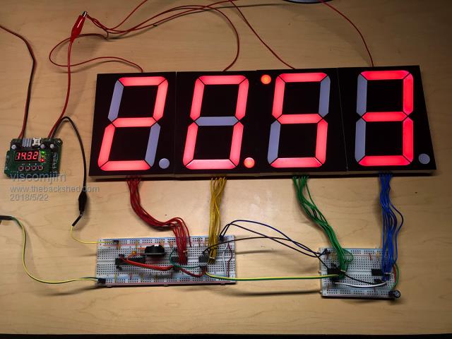

Working on a project for a buddy and he needed to drive some 5" red seven segment displays for a up/down timer. He got a bunch of them for about five bucks a piece. With a bit of googlizing, I found some really neat 7 segment drivers that can supply constant current to each segment with a SINGLE resistor... , not one on each output, just ONE resistor total.
TLC5916 .
Because these displays used 14 leds on each segment (2 x 7) and only 3 on the decimal point, I had to add one more resistor on the DP output to drop the voltage for this weird setup.
The TLC5916s can go up to 20vdc, thankfully, because these displays needed about 14.5vdc to fire up. They are shift registers so you can use SPI mode 3 and make using them very easy. I have hooked up 4 of them and naturally, had to make yet another clock, for testing purposes of course. I took the 3rd digit and rotated it 180 so that the second and third digits decimal points could form a colon of sorts.
The micromite makes this YAC project very easy, a DS3231 module, 4 TLC5916s and you're off and running. The verion 1.0 of my simple test program is only 27 lines of BASIC and shows me the time. Now I just need to add some buttons and a bit more code to be able to set the clock, set 12/24 time, dim the displays using the OE pin on the TLC5916, etc. For this simple test, I just set the time using the console to begin with.
Here is V1.0... if anybody has an interest...

Thanks for the project. I must be a little dim but how do the data figures match up to the seven segments. I have tried converting the numbers to binary and some work out, others don't. Where am I going wrong.
Brian
viscomjim
Joined: 08/01/2014
Posts: 925
Posted: 02:25pm 12 Aug 2018
Hello Brian,
The way I came up with the Digit array is I simply switched on one output at a time to see which segment lit up. My wiring from the TLC to the display was random. When I wired the display to the TLC5916, I really didn't pay attention to which segment went to which output pin. I wrote a small program to turn on each output pin, one at a time, and wrote down the value that turned on a segment. So basically I wrote a "1" to the TLC, that turned on a particular segment. Then I wrote a "2", that turn on a different segment. Then 4, 8, 16, 32, 64, and 128. Once you see which segment lights up for each output, you create the digit by adding up these numbers. Easier to see in binary.
So, for example, in my program, Digit(1) = 20
20 in binary is 00010100
So writing 20 to the TLC will turn on outputs 2 and 4 which, because of my particular wiring, turned on segments B and C, to create the number "1".
You can see also that adding 128 (binary = 10000000) to a number (output 7 on the TLC is hooked up to the decimal point) would light up the decimal point.
I hope that makes sense.
If you tell me which segments on the display (A - G and decimal point) are wired up to which outputs (0 - 7) of the TLC, I can create a Digit array for you that will work, if my explanation above doesn't make sense.

I have a set of 12" 7 segment displays mounted to a piece of black acrylic. These are used in gas station price signs and are incredibly bright. They are available up to 72" tall digits! I did a bit of reverse engineering on their driver board, which is only about $25.00, and interfaced it to the micromite using spi. Worked very well indeed. The driver board uses shift registers and transistors to drive the segments and has 2 RJ45 connections so you can daisy chain these together for as many displays as you like. This board is for 4 digits, but you can get 5 and 6 digit driver boards also. This is the driver board...
You can see in the pic below, I put one of the 5" displays above the 12" so you can see the size difference. This setup is using a micromite to create a timer for an outdoor game. It really lights up my room! You can dim it using pwm.
