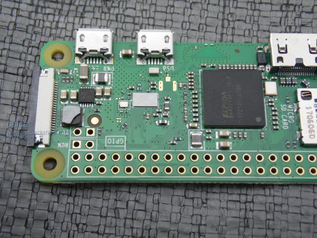

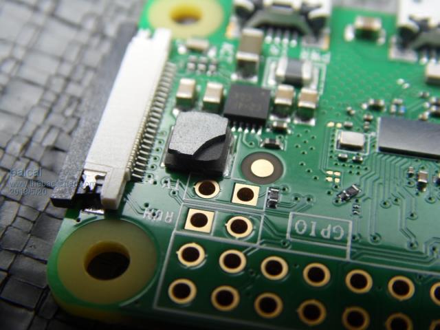

Does any one know what the chipped part is. I have found a picture where it has 4R7 printed on it so I am assuming it is a 4.7 ohm resistor and by its size maybe .5 watt, I thought maybe someone could confirm that. I received this board damaged and the seller is sending a replacement so I thought I would see if I can repair this one.
Paul.
edit... When I first applied power the green led fickered but now nothing so I am thinking it is a resistor in the power supply circuit. I can't find a pi zero Schematic anywhere.
edit again.... the reason the led stopped fickering was because I had removed the sd card. I know nothing about pi zero the led flickered for a while and now it is on steady, was it reading the card. I will have to find a tutorial somewhere.Edited by palcal 2018-05-21

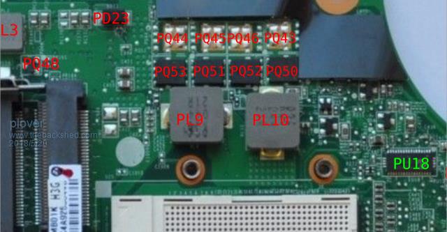

Yes circuit diagram would be nice, just did a quick look on the internet, here is a pic from some work I did trying to repair a laptop.
Sorry about details but it gives an idea of what an inductor may look like
They may have more writing than a resistor upon them. PL are inductors, some mosfets above give size idea
Edited by plover 2018-05-21

I believe that you'll find it's a 4.7uH inductor. The layout with the IC next to it is textbook switching power supply.

I tend to agree with ryanm. When I looked at my Pi-0 under the microscope, you can clearly see that there is enamelled wire going in one side, and coming out the other. It is sealed up in black gunk, probably to stop any HF resonance from being heard.

Just looked at my Zero-W (which I've yet to fire-up) and I think the 4.7 device is more likely a 4.7uH inductor. Reason is that the 12 pin chip alongside it is a 2306KE (just managed to read it with a magnifier) which is a step-down regulator so that needs an inductor and the smd versions of them look like that one.

I wouldn't be surprised if it still works once you've loaded an OS onto the SD card. Loosing a chunk of ferrite material will alter the inductance a bit, but I can't see any coil broken. SMPS usually have a fair bit of tolerance for varying inductance values and the chip brand new out of the factory would only have had an accuracy in the +- 20-30% range.

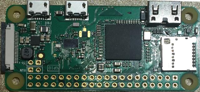

Hi Paul,
Here is a photo of my Pi-W
Kind Regards,

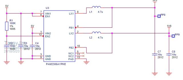

Posted: 03:07am 20 May 2018
Schenatic of the pi zero W power supply areas.
Extracted form
https://www.raspberrypi.org/documentation/hardware/raspberrypi/schematics/rpi_SCH_ZeroW_1p1_reduced.pdf
4.7uH stands out as a likely suspect.

Thanks for all the replies, after that I am sure it is an inductor, I didn't think they used R with an inductor but there you go. Looking closely at the broken component it sure looks like ferrite. However I burnt an SD card with Raspian stretch and the blinking LED seems to be the file loading, after a while the LED settles down solid green. So I think all is OK. I was like a kid with a new toy and instead of reading a tutorial I just started connecting it up. But need a USB hub and an adapter cable for the monitor. I really only bought it to play with the Picromite but now I think I will play with it a bit more first.
