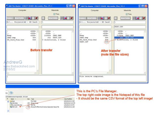

I now see the file on the SD card but it appears (using quick view) to only be a listing of the program! BUT:
- if I read the file line by line from the console (eg ... Line Input #1, In$: print In$ ...) I see the correct data
- if I use MMEdit to transfer the file to the PC I see only the program listing
- if I take the SD card and read it in the PC I see the correct data!
I suspect a MMEdit issue?
Andrew
(it does it with the SD card in either slot)

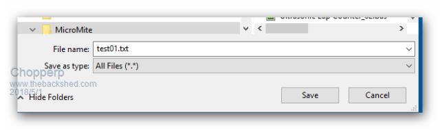

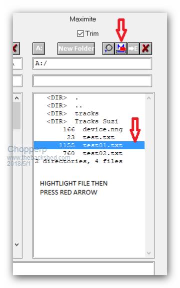

What I am doing right now testing SD cards is in the right column of MM File Master, highlight the appropriate file (Click on the file you want to transfer), then click the red arrow icon above it (2 over from New Folder). A windows directory comes up & then save from there.Edited by Chopperp 2018-05-02

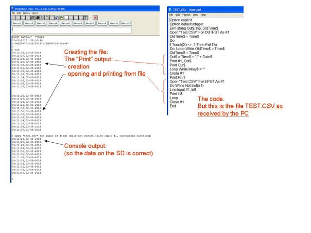

If I do this from the console:
"open "test2.csv" for input as #1:do while not eof(#1):line input #1, Out$:print out$:loop" - I get the correct listing of the data file.
If I open MM file manager and use the file viewer (the icon to the left of the red arrow) all it contains is a listing of the program.
When I transfer the file (via the red arrow) the one that gets to the PC is is just a listing of the program (smaller than the data file of the same name)
If I put the SD card in the PC it is the correct data file.
(I'm out for a couple of hours so a lack of response is not a lack of interest)
Andrew
Chopperp
Joined: 03/01/2018
Posts: 1139
Posted: 07:22am 01 May 2018
Ah, that's what that button is for. That's not working for me either for transfer.
Don't select the Quickview button.
Just select the file & click the red arrow icon. (Image 1)
This will transfer the file to the directory you select. (Image 2)
You will need to open the PC directory to get the file. (Image 3)

Hi Chopper,
Thanks but still no joy. That is what I have been doing and my screen grabs are ~ the same as yours.
(I've tried every inconceivable combination but am of course happy to try more.)
