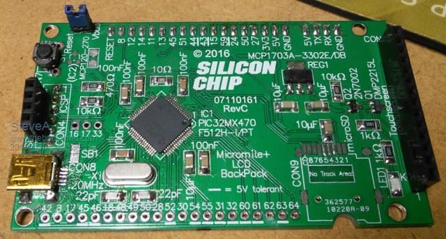

I seem to recall that Silicon Chip did a MicroMite Plus Backpack. It might have been a Geoff design, or a Peter(matherp) design, but I can't remember. That gives the MM+ feature-set, along with a graphic LCD. I think it still used an SPI LCD. I will have a hunt through my SC issues to see if I can find where it was published.
SteveA
Joined: 10/03/2017
Posts: 49
Posted: 11:02am 30 Apr 2018
  Quote  I seem to recall that Silicon Chip did a MicroMite Plus Backpack
'The Micromite Plus LCD BackPack' - November 2016 page 64 - 73
I've built two of them, they work well. The only small difficulty is soldering the smd PIC and USB socket.
The LCD/touchscreen plugs into the raised headers on the left and right. Any additional electronics you need can be mounted underneath, the processor pins are brought out to the top and bottom rows of pins.
Note that the touchscreen has a SD card socket, so I don't use CON9 on the pcb.
Here in the UK, I think EPE also did a series of articles about it.Edited by SteveA 2018-05-01

I purchased the SC uMite Plus LCD BackPack (Nov, 2016) several months ago & have only just finished assembling it. I do not have a real purpose for it as yet. Just wanted to see what all the fuss was about with the newer 'Mites. (I do have others).
You will need good magnification & a fine tipped soldering iron (and a clean workbench) to assemble it. (Says all this in the instructions). It also needs a good clean 5V power supply. I had much fun trying to get mine to go properly, particularly the USB connection because my USB PC supplies were bit below par & couldn't handle the LCD backlight above about 10%.
I've updated mine to the latest firmware release from Geoff (day or two ago). Seems to go OK. The SC Website shows a fairly recent release.
Just finished checking that the appropriate outputs go high when set. All good. Did previously have one LCD pin that didn't.
It would be worth while having a look at it.
Pretty resilient. Accidentally shoved 12V up one of the Console pins tonight & it survived. (oops)
SC changed pin numbers around a bit which makes things a bit awkward when following examples etc in the manuals.

  Quote  I had much fun trying to get mine to go properly, particularly the USB connection because my USB PC supplies were bit below par & couldn't handle the LCD backlight above about 10%.
I had that problem too. I found using a short USB lead with thick copper cores helped, I think it was voltage drop caused by resistance in the cable.

  SteveA said   The only small difficulty is soldering the smd PIC and USB socket.
Totally agree with that, SteveA.
Can you elaborate on how you mount extra stuff? I've got mine socketted onto a big bit of a strip board ATM (with power supply) for testing etc until I decide what to do with it. Be room underneath for some stuff as you mentioned.

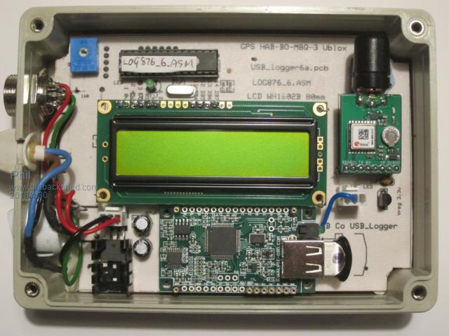

Attached might be an image of my last effort which used a PIC32 USB storage module. All the hard work done for me though the file formatting was unusual!

Phil, Interesting looking set up.
The SC kit comes with the Touch LCD panel if that's what you are worried about.

The MM LCD Backpack, MM V2 LCD Backpack and MM Plus LCD Backpack are great designs for Colour LCD Panels.
Working with the colour screen is very easy and can be a nice option for a professional looking user interface and is useful to use colours to flag, highlight and differentiate things.
Once you get used to using the touch interface you will not look back. In most cases you will be able do without operator switches but still allow the operator to select options (software controlled) and present different screens as needed.
You can always leave off anything you don't need, but to be honest there is not that much spare on the LCD backpacks.

The MM plus LCD backpack is the same physical size (2.8" 320 x 240 screen). It does use SMD but is so capable. The SD card works well, four serial ports etc.
The beauty of either is that once built they are easy to test ideas via breadboard before launching into a circuit and a box.

Andrew, you are right. The MM + LCD backpack with SD looks the best bet. Can buy it assembled. Just need the LCD. Best source?

I tend to breadboard new ideas, then once I'm happy with them I transfer them to stripboard or sometimes homemade pcbs. So I end up with a stack of 3, lcd on top, micromite in the middle, my circuit on the bottom.
I interconnect the boards using pcb headerstrips and pins, just like the ones the lcd connection uses.
The boards are held together with long screws and nuts, it makes for a cheap and remarkably robust solution.
