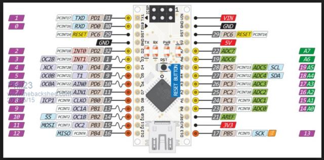

Just wondering whether a pin remapping adaptor would be useful in some instances,
like taking PCB's designed to accept a Nano & use an E28 in it's place.
Basically it would just need two rows of 15 pins on each side, & the traces to remap them.
1st & 3rd row could accept the E28, & the 2nd & 4th provide the Nano output pattern.
There's quite a few interesting projects out there with PCB's available that accept either Uno's or Nano's.
The ones that rely on Uno's should be easily ported with a CGMicroboard2, but the ones that use Nano's couldn't directly accept an E-28.
Does it sound at all useful?

  Phil23 said   Not sure how the setpin page ended up in that post, as I didn't actually get to finish it.
I was a bit confused how it related to the pinouts, now it makes sense.
I think that pin layout diagram is great, what was it done in?

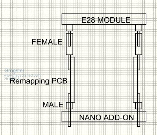

The issue I see with this, is that weather you had the extra row of pins on the inside or the outside of the E28, the footprint would still be wrong for the Nano add-on boards then. Perhaps I am missing something?
Because the E28 is designed to be the same size as a Nano, there is no room to move either side.
Perhaps you could do this with narrow little PCB's where you had female strips at the top, and male strips at the bottom, and the remapping on the little PCB's.
Like this:
That would stand tall though, and personally, I think it would look a little ugly.

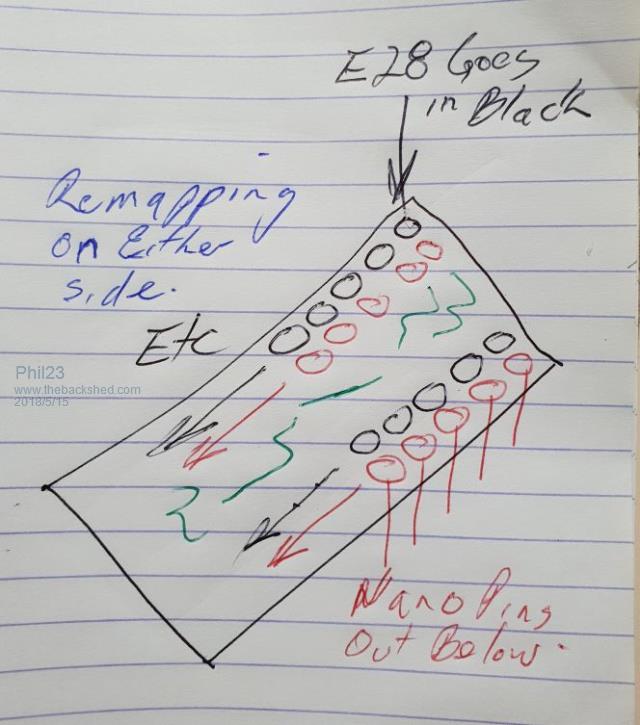

  Grogster said   The issue I see with this, is that weather you had the extra row of pins on the inside or the outside of the E28, the footprint would still be wrong for the Nano add-on boards then. Perhaps I am missing something?
It would need to be at least 0.1" or so wider.
So it was a single board that sat underneath the E28.
E28 sits on top, the 2 rows of Nano pins stick out the bottom, both to say the right of the E28 row.
Remapping on double sided PCB should be doable.
My CAD representation....
It could use pins & sockets, or just joined with pins like Rob's Nano ASCII programmer, which would ne neat, but jut a bit wider in overall width.
Phil.

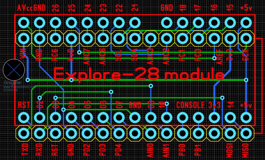

Posts: 10081
Posted: 12:35am 19 May 2018
This is what I have so far:
Not all of the Nano pins can be mapped to the E28, but I HAVE mapped the SPI port, the I2C port, COM2 and the console. Pins marked as ADC are MM ADC pins. Pins marked as PB/PC etc are just standard I/O pins. I will make up a proper pin map spreadsheet chart thing once you are happy with what we have.

Posts: 10081
Posted: 12:44am 19 May 2018
Is this the sort of thing you are after though?
Can you see any obvious changes you would like made?

Posted: 10:09am 05 Jun 2018
Hi Grog,
All looks pretty good to me.
Looking about there's a swag of PCB's out there designed to serve a purpose & controlled by a Nano.
Most look like they could also be driven by basic.
Usually their pin usage count from the Nano is fairly small so the few missing ones in the conversion shouldn't count.
I did briefly think that maybe just a 28 pin DIL on a Nano foot print board was an alternate solution, but there'd be no space for the 1455 & USB would be lost; ant that direction would essentially be designing an new alternate Micromite.
Just remapping the E-28 seem a much more sensible solution.
Phil.

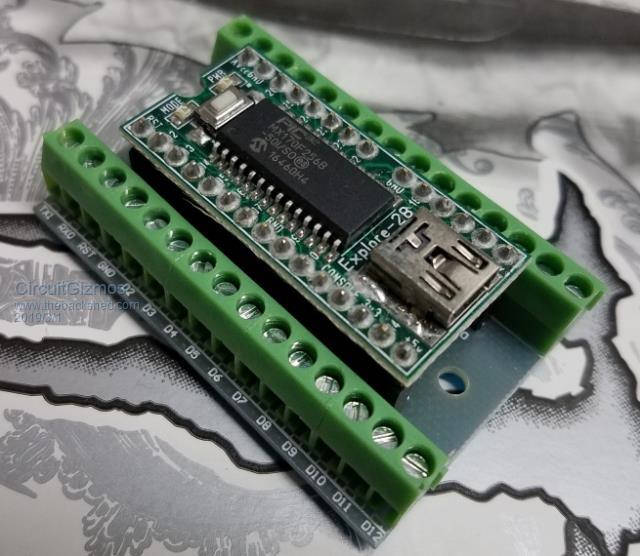

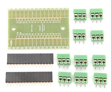

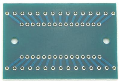

I was looking for parts on www.banggood.com to see if prices had changed on a few
items I got last year. I found this that may be of use to E28 users. And remembered
this post.
I had picked up a few of ones like these but thay had the Ground pads tied where
these are nicely just raw point to point.
A fast way to make use of an E28.
