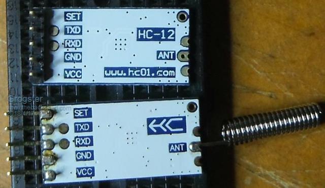

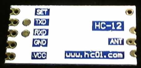

Looking at the modules up close, they appear to be identical electronically, but there is a silkscreen difference with the newer ones over the older ones:
The module with the helical fitted is the OLD one. Note that the newer one has the website on the bottom silkscreen.

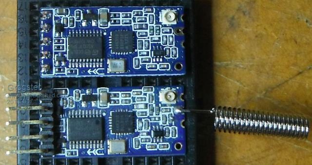

No, both have helicals. I just left the helical on the old one, so you can easily see the difference between the two in the photos.

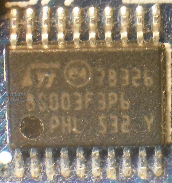

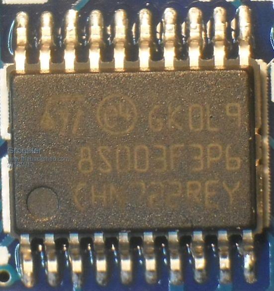

Here are close-up shots of the MCU's, which do appear to be a different part number:
OLD HC-12 MCU:
NEW HC-12 MCU:
It is possible I am on the wrong track here - I don't really know my ST part numbers, so it might just be an equivalent part.
EDIT: I take that back - they both seem the same. The ST part number would appear to be the 2nd line, not the first one. Both 2nd lines match, so I expect that is the actual MCU part number, meaning both modules are EXACTLY the same.
I need a large Whisky.....Edited by Grogster 2018-04-18

This is the chip the bottom right is the date and revision code (page 93 in the manual).
So they are both rev Y of the same chip AFAICT (as far as I can tell).Edited by Azure 2018-04-18

Both exactly the same part, that being "44631B" on the chip, which is a Si4463 revision 1B, so the RF chips are identical.
Looking at the datasheet, page 33 talks about setting the frequency synth, and so I suspect that in the latest version of the HC12 firmware(in the ST chip on the module), they have changed the stepping factor for setting the frequency, which would explain this issue.
To confirm this, I could swap the ST chips between the boards. If that is indeed the case, then that would make the NEW one behave if you see what I am getting at. Naturally, that is not a practical fix for the issue, but it would prove one way or another if the ST MCU is the problem here, and I now suspect that it is - it HAS to be, cos everything else is identical between the two different boards.

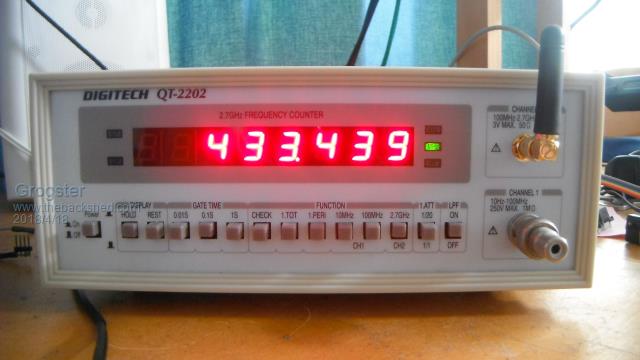

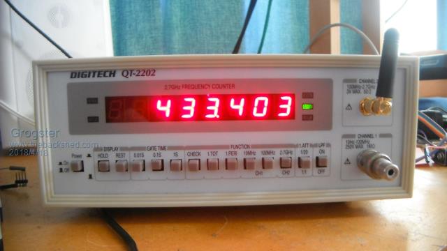

Here is a little evidence of what I am saying:
NEW module on Channel 1(433.400MHz):
OLD module on Channel 1(433.400MHz):
Definitely a 30kHz or so frequency problem.

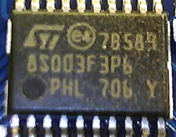

Hmmm... I am wondering if there is something "hooky" about the new modules you have.
The ones I have in stock (with the URL on the silk) match precisely what you show and according to my scanner, 433.4MHz - not as precise as your measurement though.
pix...
Only difference I see is mine have a Philippines version Y of the chip whereas yours are China (?)
I think from what you are showing, they are out of spec with the datasheet - that's enough to go back to the supplier I reckon.
