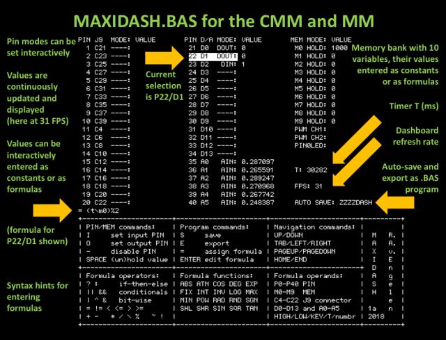

MAXIDASH is a dashboard, and an IDE of sorts, for the (colour) maximite. MAXIDASH is an MMBASIC 4 program that runs on the MM to experiment with an MM and to build event-driven programs. You can interactively control pins/ports and enter values and formulas for pins, pretty much like you would enter values and formulas into a spreadsheet. The formulas can be saved and exported to a stand-alone .BAS program.
My design goals for MAXIDASH were:
- I wanted a UI in MMBASIC to immediately give me an overview of pins and connectors and their state, mode and values, to toggle pin modes (restricted to their capability), display pin values or enter their values/formulas;
- I wanted the UI to be interactive, to set pin modes and enter values and formulas while the display is continuously updating (entering formulas requires some tricks to extend the program on the fly );
- the formulas are expressive, including if-then-else (with the C-like ternary operator ? and : pair), conditional operators || and &&, arithmetic, BASIC functions, values of pins and memory cells (Pn, Mn, Dn, An, Cn), timer (T), and key press (KEY);
- fast screen updating, so pin values are read or set at each cycle in a fraction of a second;
- the ability to temporary "hold" values, which suspends updating pin/mem values;
- a feature to save and export pin settings and the pin-updating formulas to .BAS files, to integrate the generated code easily in MMBASIC projects;
Below is an overview of the UI display on a VGA monitor of the current version:
