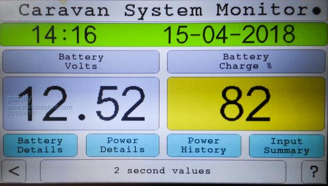

panky
PS. Quick peek at one of the user displays.

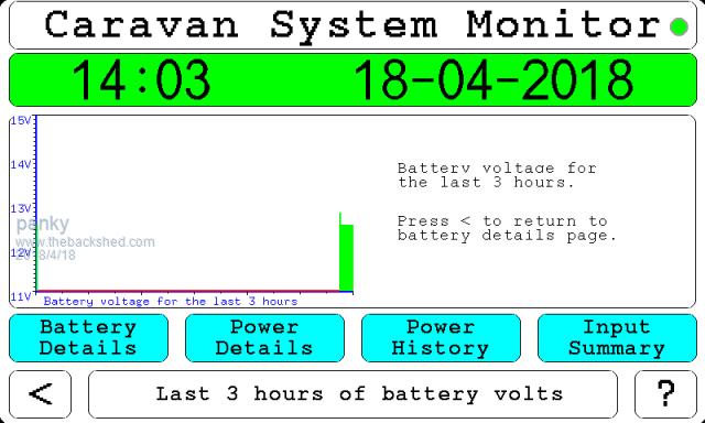

Update:
Fixed a few bugs and got the history graphs working.
The software below will work in simulate mode if COM1 Rx and Tx are looped back.
Had a struggle with integrating GUI displays, touch and plain graphics - I hope the comments are enough to explain the operation. A detailed explanation can be found on Fruit of the Shed here however the software below is the latest and most stable version.

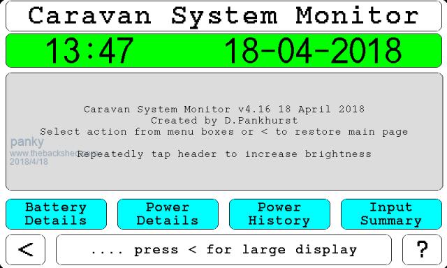

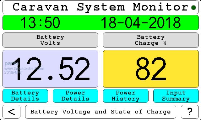

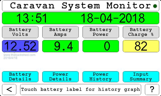

Some screen shots:

...... just a quick note - when you run the program, nothing much happens until the next minute rollover to allow a clean entry into the program. Comment out the GETRTC statement if you don't have a RTC connected.
Enjoy,
Doug.
