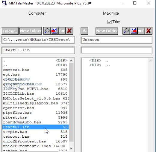

Hi Gerry. Sorry to say it didn't work with the #LIBRARYLOAD filename directive. MMEdit just loads the file as TEMP.BAS into the CMM. No saving to the directory. Code snippet below. I think it is correct
#LIBRARYLOAD Start01.lib
#LIBRARYSTART
Sub Start_01
dim T(10)
end sub
#LIBRARYEND
ChopperP
disco4now
Joined: 18/12/2014
Posts: 1159
Posted: 03:05am 15 Apr 2018
Your code snippet is correct. It created the file for me. Is the Run External Command thing checked. I checked the uploaded file and I have given you the correct file this time.
Also if you put a debug.txt file (or rename debugXXX.txt in directory where mmreplace.exe lives it will pause so you can see the the console output before it closes. You need to hit enter to continue.
Gerry
F4 H7FotSF4xGT
Chopperp
Joined: 03/01/2018
Posts: 1139
Posted: 04:33am 15 Apr 2018
I get this..Can't see a file though

Can you check there is only a single space between #LIBRARYLOAD and Start01.lib in the directive
It currently cant handle more than one space or a TAB here.
F4 H7FotSF4xGT
Chopperp
Joined: 03/01/2018
Posts: 1139
Posted: 08:04am 15 Apr 2018
TBS Connection playing up. Keep losing my posts.
Space OK.
Noted adding your MMReplace file removes the /*...*/ sections from the Basic file. Undo brings it back.
If LIBRARY directives are in place (with or without the filename) & then I click on Advanced, Run External Prog, MMReplace removes everything apart from the Library file. This file can then be saved as a *.LIB file ready to be uploaded to the SD card.
The original file has to be reloaded of course.
This is a good compromise. Happy with that. Maybe, that's what I supposed to be doing anyway.
Now to see if this will post (preview works)
