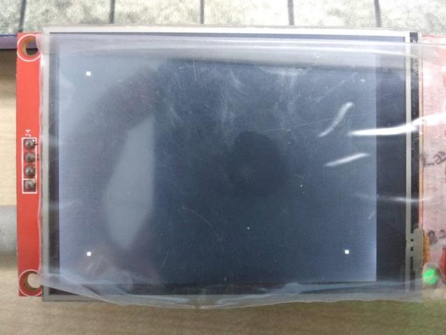

I write 'GUI CALIBRATE' and then touch the targets, the result is
Done. No errors
Deviation X = 0, Y = 0 (pixels)
Then I write 'GUI TEST TOUCH'. When I randomly touch the screen, somehow there are 3 dots appeared.

Rather weird, It has definitely calibrated OK, I usually just drag my finger nail across the screen and it draws a trace. I take it the plastic is to stop the camera flash reflecting. Other than that maybe Matherp can help, or send a PM to WhiteWizzard.

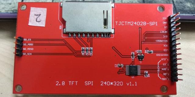

Are you sure your display has the TOUCH function. It is possible to buy displays without this function. They still have the touch pins on the back but U1 is missing from the board.
Paul.

Remove the protective plastic film from the LCD. The touch always just works, usually. All LCD's from tiny SPI ones up to 8" parallel ones all tend to use the same XPT2046 touch controller, and there must be literally thousands of these in use on Micromite chips now, and they 'Just work'.

I have U1 on my TFT board.
I did continuity test using multimeter and all connection are just fine. So I guess there is no soldering issues?
Eventho I remove the plastic film from the screen, the touch still cannot be traced.
