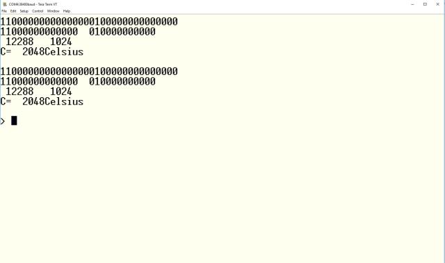

Here is what I get returned from approx 18deg room temp. (the 2nd Row shows the Thermocouple TIP 14 bits and the Internal `cold' junction 12 bit temperature both in binary)
If I warm up the thermocouple it does change but non-sensibly, The fault bit is always 0 unless I short the thermocouple to GND then I can see it change.
Anyway I would appreciate if someone can see what is wrong or provide a snippet of complete working code for me to try on a 28 pin MM.
I have now tried 3 different Max PCBs and about 5 thermocouples of various shapes but all are K-Type.

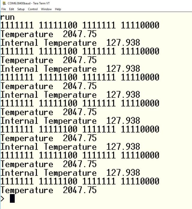

Ok I tried your code but similarly I get incorrect readings (basically the same as my 32 bit SPI code)
I had to change your code to suit my CS of pin(15) and also you used a variable called ERROR which gave me a syntax error so I changed that to ERROR1 I also added a print routine to show what all four SPI reads are and a 2 second delay to see what I received.
Here is the result I see after those changes
Here is the code with my Alterations

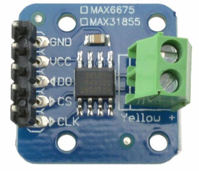

@Chronic,,
The modules I bought are all the same I will post a link next time I am in front of a pc..
They had pin 1 and 2 shorted together on the pcb so I cut the track between them..
The circuit buzzed out to the data sheet sample cct.. but of course I may have missed something else
I might desolder everything and start from scratch..

Print "Thermocouple Error"
Pause 1000
TempMSB = Temp(0)*16
TempLSB = ShiftR(Temp(1),4)
TempDP = (ShiftR(Temp(1),2) And &B00000011) * .25
Temperature = TempMSB + TempLSB + TempDP
Print "Temperature ";Temperature
TempIntMSB = Temp(2)
TempIntLSB = ShiftR(Temp(3),4)
TempIntDP = TempintLSB * 0.0625
TempInt = TempIntMSB + TempIntDP
Print "Internal Temperature ";TempInt
