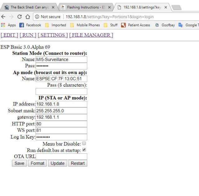

What I have done is once it Flashed I connected it to my router with a static IP address
Just put your WIFI Name and password in and the IP address you want to use (no changes to the router needed)
Remember to tick RUN default.bas at startup and after you click run the 1st time, any time you reboot it will run automatically

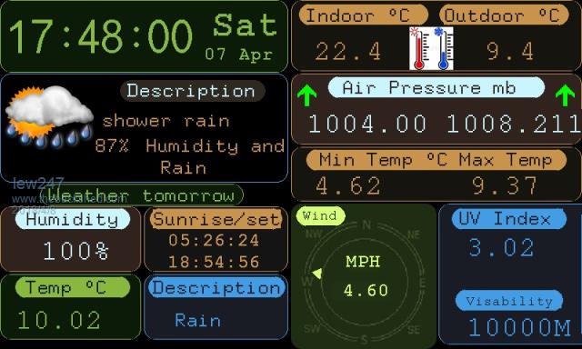

Here's how it looks now
The "Weather tomorrow" box could be used as the forecast button
Ideally when it's finished I'd like to have a logger that will shows graphs of the weather over the past week/month/year and writes to the serial flash chip on the back of the LCD display rather than using the SD Card
I did try changing the pictures to ascii.ppm format so they would run from the serial flash but I couldn't get the pictures converted so they would work.
The reason I'd like to do this last bit is because occasionally I get "SD Card Not Found" when it goes to update the weather icon and also because the SD card sticks out of the bottom of the display and it's going to be a right PITA to get some kind of case for it
EDIT: Updated the Zip file as it had an error in the code*
I also just noticed the pressure for tomorrow has 3 digits, no idea how that happened because I've set it at 2 decimal placesEdited by lew247 2018-04-09
