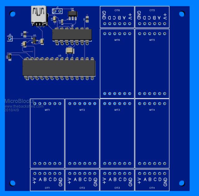

Posted: 11:46am 08 Apr 2018
I just ordered about 200US$ stuff (enclosures (size 2 and size 3), tibbit covers, some modules etc).
Hopefully that will be enough to determine the exact sizes.
I think the first try should be for a size 2 enclosure as that has a size a little bit smaller then 10x10cm.This size is very affordable for making PCB's.
I am now studying the connections for each 'tile'. I could use some help with that as more eyes will see more.
The size 2 enclosure has 3 'tiles' that can accomodate up to 6 tibbit sized modules.
Each module has 4 i/o lines so a max of 24 lines will be available to connect.
A 28 pin mx170 will be able to use about 22 of those, so for a first try i will suggest this easier and more affordable approach.
If that works we can scaleup to bigger chips.
Any suggestions (especiallyu at this stage) are very welcome.
I am eager to get this going as i have this on a 'backburner' for some time.
These enclosures, for very affordable prices is a big enabler!
Now lets first see how long it takes to get the stuff that i ordered.:)
Posted: 01:27pm 08 Apr 2018
They are fast. Just got confirmation that it is packed and ready to ship first thing tomorrow. Good start.
I made a quick pcb layout which matches the size 2 enclosure. Just thrown in the components to see if there is enough room. :)
It has a USB connector, the 1455 and the MX170. All through hole! And it still fits. Also (still smd) part for supervisory and 3.3v regulator, together with the neede3d caps and resistors. They can easily be replaced with through hole parts also.
The 64 or 100 pin chips in TQFP packaghes would fit also when all the other parts are also SMD, but that is for later.
This size 2 enclosure would also be a perfect fit for a Color Maximite. Together with some joystick (D9) connectors, Keyboard (PS/2) and a VGA (D15) it would probably fit comfortably.
Edited by MicroBlocks 2018-04-10
