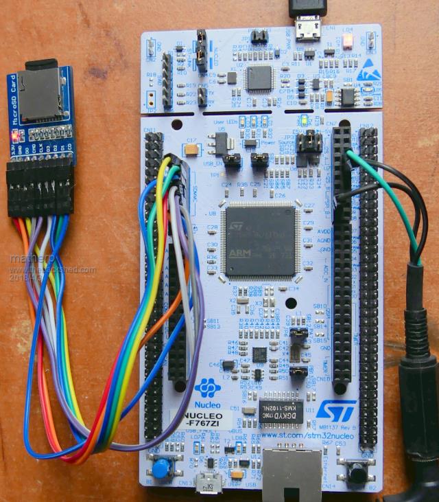

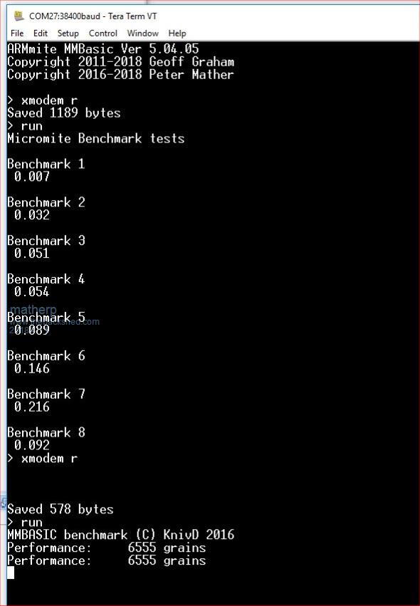

In preparation for the availability of the STM32H7 (400MHz). I've been working to get MMBasic running on the STM32F7. My development board is a Nucleo-F767ZI which other than the H7 is top of the STM line-up:
216MHz
2MB flash
512Mb RAM
Double precision FPU
In essence then it is very equivalent to the PIC32MZ.
In practice at 216MHz it is just marginally slower than the PIC at 252MHz, but considerably faster than the PIC at 200MHz.
What then are the advantages of the STM?
ARM core - so much more mainstream
Much better software infrastructure - free high quality IDEs and compilers
2 * 12-bit DACs so enhanced audio capability
Cheap development boards ideal for building into projects
The current status is that MMBasic is up and running with the latest Micromite version. SDcard support is fully implemented and uses the fast SDIO 4-bit parallel interface (this should also be possible on the PIC but the documentation and support for this is so poor that there is no evidence anyone has got it working).
Audio is fully implemented with support for WAV and FLAC file payback through the DACs, Tone generation and SAM test-to-speech (like the MMX). Programs can be downloaded through MMEdit or XModem and the editor is fully functional.
This cracks the hardest bits of the port but left to do are the wide range of other IO and TFT capabilities of the Micromite.
