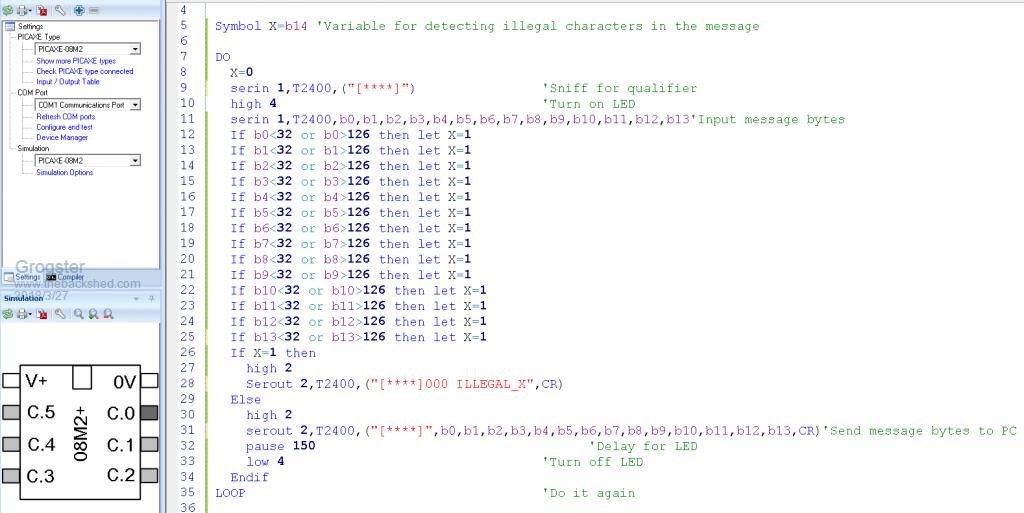

Yes, I still use PICAXE from time to time for simple stuff, but when I went to change a program for a data-filter I use an 08M2 for, the PICAXE program won't let me do it.
It keeps complaining about an IF without matching ENDIF, but from what I can see, I HAVE the endif in the right place. It is complaining about line 25 having that problem, but it does not care at all about the other 12 IF's above it needing an ENDIF....
Do any of the members here who still work with PICAXE know where I am wrong?
....I've got WAY to used to using MMBASIC, and I think I have forgotten some of my PICAXE-BASIC.

You probably need to terminate each of the 14 or so " IF b0....etc" lines with an endif .

You're right, I did have to!
As they are all single-line IF/THEN's, I did not expect they would need endif's of their own....
Oh well. Code passes syntax test now. Will now see if it works.

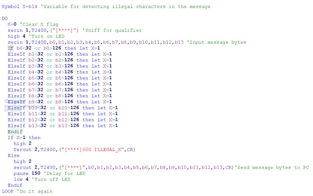

Speed may not matter, but if you put ":" after each "then" and change the "IF"s after the first one to ELSEIF and put an "ENDIF" at the end, then the comparisons will cease after the first invalid one is found (no ENDIF per line needed).
Posts: 10076
Posted: 11:34pm 27 Mar 2018
Do you mean like this?
This compiles fine too.Edited by Grogster 2018-03-29
