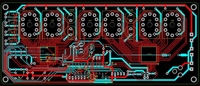

Prompted by redrok's thread I've designed a PCB for a MM2 based Nixie clock.
The requirements I designed to were as follows:
Low cost Nixie tubes
Easy to solder
12V supply
GPS or DS3231 as clock source
IR or push button control
Minimum off-PCB connections
The layout I've come up with is as follows:
All components are through hole except for the HV5530PJ-G which are 1.27mm pin pitch (easy to solder) and the DS3231 if fitted.
Power supply is 12V feeding a cheap high voltage converter like this.
The Nixie tube set is also cheap. This is the set I have ordered
These can be soldered direct to the PCB or connected using standoff sockets
The PCB is 167mm * 69mm – cost USD55 for 10 including HK post shipping (PCBGogo)
The circuit is:
2018-03-26_202109_Nixie_-_Project.pdf
The key component is Microchip's high voltage 32-bit serial to parallel converter HV5530PJ-G This is an SMD part but is on a 1.27mm pin pitch (easy). This runs on 12V logic and coupled with the MOSFET level changers completely isolates the MM2 from the high voltage supplies to the Nixie tubes and allows three tubes to be driven by a single chip. The 4-dots comprising the "colons" can be individually driven allowing alarm setting and status to be indicated by your software.
I'm currently waiting on parts to prototype the key bits of the circuit. Assuming this is OK I'll get some PCBs made. If you are interested in a PCB, WW has agreed to stock them but please note:
WARNING HIGH VOLTAGES
This project uses high voltage (180VDC) to drive the Nixie tubes. If you want to build this or other high voltage projects you should ensure you are fully familiar with the safety requirements of working with high voltages. The 12V supply to this project must be fully isolated from the mains.
I believe the track to track clearances on the PCB are adequate for the 180V low current supply, certainly they are greater than the pin spacings on the driver chip but any builds based on this design are at your own risk

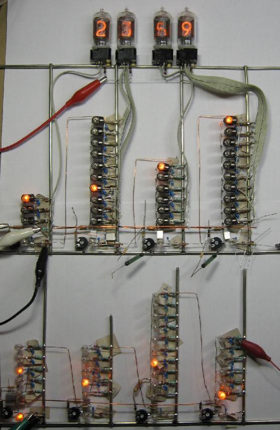

For the hardcore "neon" technology fans - but not stable in the end...
All Nixie/Bulb Clock
cheers

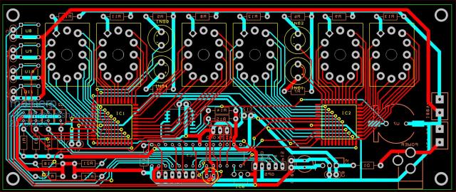

The Nixie tubes arrived yesterday and......
The footprint was upside down on my layout and I want them at the top of the PCB so had to do some serious rework. However, other than that the circuit seems to work nicely when prototyped.
I've also put a footprint for a TEMT6000 light sensor on the front of the PCB so the clock can be auto-dimming.
2018-04-13_013313_Nixie_-_Project.pdf

I wish I had caught that as I did look over the layout when you first posted it.
I have a text file I have been using in my Nixie Clock design.
This has been very useful so I don't get things confused.

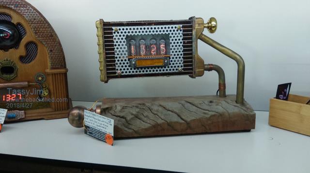

Saw this in an "antique" shop today.
It's still on the shelf it you are interested. The price is over the top - $1750.00 Beside it is a fake (or butchered) radio with an old digital clock planted in the center.
JimEdited by TassyJim 2018-04-28
