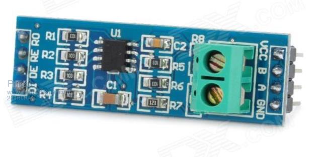

Have a few of these modules.
Presume I can't directly connect them straight to a 28 pin chip.

Is it at all possible to invert this signal in software to avoid the additional device?
I know Geoff wrote a C-Function to manipulate the state of certain pins.
Is that relevant in this case?
Would be nice if the MAX485 could just be directly connected.

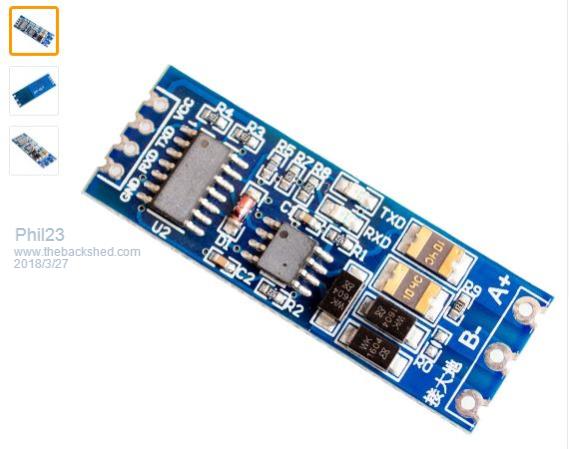

Also some alternate Modules arrived yesterday.
These,
https://www.aliexpress.com/item/TTL-turn-RS485-module-485-to-serial-UART-level-mutual-conversion-hardware-automatic-flow -control/32709226383.html?spm=a2g0s.9042311.0.0.0pGBWV
They might be easier to live with as they handle the flow control themselves.
