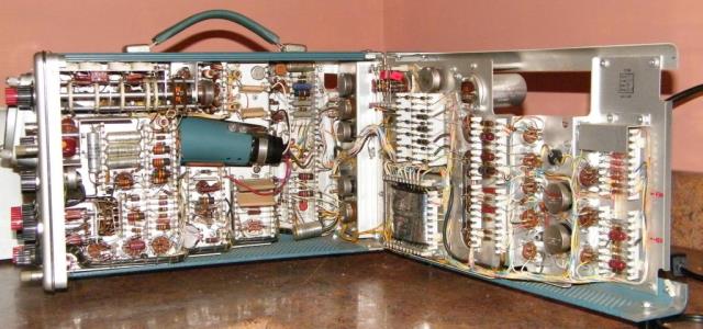

Back in the days of vacuum tubes but before printed circuit boards Tektronix would mount most passive components on Dick Goodfellow's ceramic strips which had silver plated copper notches inserted into their surfaces using only silver solder to secure the components. This is a 1955 310a which employed John Kobbe's DC coupled unblanking circuit and Dick Ropiequet's Schmitt triggered precision wide-band calibrated linear time base generator. With the fold out chassis design they managed to stuff 30 vacuum tubes and the CRT into a cabinet measuring 6.75" x 10" x 17" weighing 24 pounds! Take a good look at one of the best electronic designs of the century! It looks like is was built by a jeweler! Pan Am had hundreds of this vintage of scopes floating around the electronic shops on their wheeled carts. The knobs were all big enough for me to grab with my big fingers!
Stuff would stick to the surface of the ceramic strips and performance would slowly degrade. When one of these malfunctioning babies arrived in a Tek repair shop they would submerge it in a bathtub filled with sudsy water for a 24 hours, then give it a ten minute shower with tap water, they a quick spray with distilled water, then a quick spray with alcohol, then 24 hours in an oven at 120°F to thoroughly dry the ceramic strips. Finally they would apply a tiny drop of Cramolin to each of the rotary switches using a very fine artist's brush. Then they would plug it in. Most of the performance problems were gone after the vacation at the spa.
Today, I suspect that water filtered by the commonly available reverse osmosis filters would be sufficiently de-mineralized so that the distilled water and alcohol rinses would probably be unnecessary. Whatever you soak it in, dry it thoroughly!
