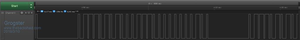

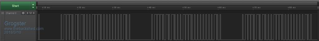

I hooked up a 470 receiver to my logic analyser and this is the output:
The sync seems to be about 6ms in length, followed by the data. This repeats like this:
When no button is being pressed, the data is just white-noise.
EDIT: Forum software is compressing these images, so they look a little fuzzy. Let me know if you want me to link to un-squeezed versions on Dripbox. (Dropbox)
EDIT: Each of the bits in the packet appear to be 0.8ms each, regardless of if they are zeros or ones.Edited by Grogster 2018-03-11

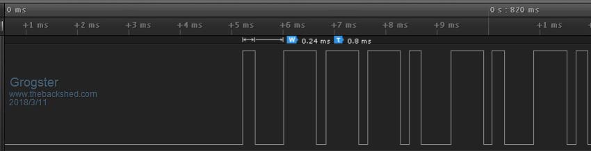

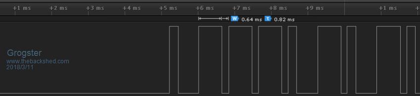

@ WW - As per the 2nd datasheet which has a bit more information, they say that each word consists of a sync bit, 20 address bits, and 4 data bits, so 25-bit. 24-bit if you don't count the sync bit.
Your interpretation of the data is how I see it, yes. Basically, looking at the datasheet, a short pulse-width is a zero, and a long pulse-width is a 1.
Here are images of the first two bits following the sync bit:
